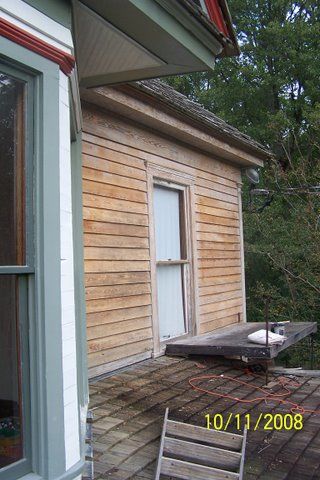

Okay – this was all PaintShaved and SpeedHeated clean in July of 2006. No joke. I’ll show that process when I get back to it. Now, I’ve gone over it all with 80-grit in a 5″ ROS to bring it to bright wood again. Every nail has been nailed beside with a SS 6p ring-shanked box nail – by far the best for this – no splitting, and great grip.
Then, it was sprayed down with 50/50 mix of Clorox and water in garden sprayer; then hosed off with a garden hose four hours later.
After the wood was dry to the touch, any raised grain areas were hit again – not too many, since this had been mostly exposed for two years.
Then, I sprayed on WoodLife, a clear penetrating wood-treatment, which was allowed to dry. When it’s dry, more water sprayed on will actually bead up.
Then, first coat of Porter Bonding Primer, brushed on well.
This afternoon will be caulk and filler rod, and maybe prime those parts again Tuesday evening

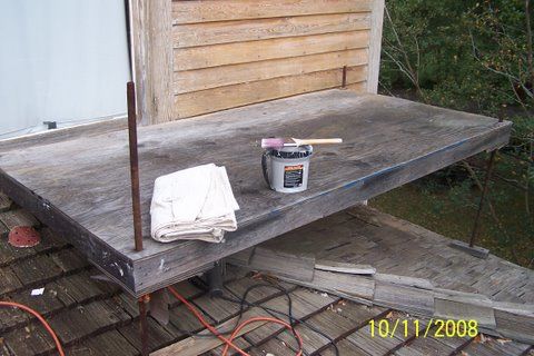

As a side note – I’m pleased that my adjustable work platform, on upside-down PonyClamps, was just fine after the years up on the roof.

Good to see another picture thread from you. Look forward to seing it.
BTW... like the adjustable platform using pony clamps, have to remember that one.

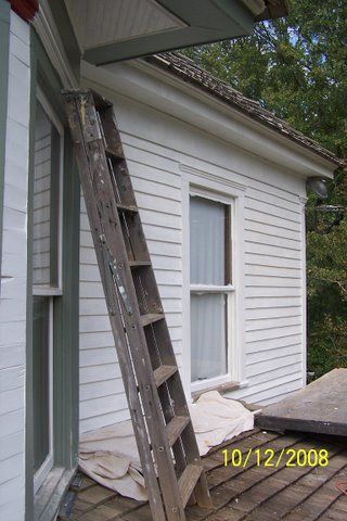

Here's an "as-is" pic of just around the corner from where I'm working -

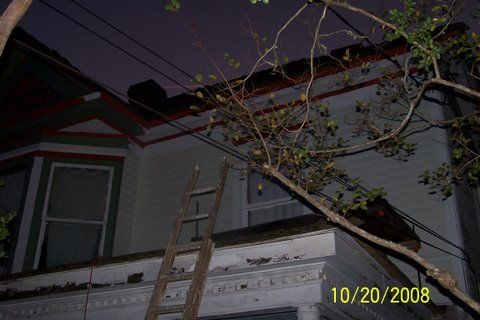

Made it! Now to cut in all the green trim and darker sash. Can you see the part I can't reach without moving my platform?

Forrest-master of bad lighting :^)
You going with a 'Forrest' green on the trim?'Man who say it cannot be done should not interrupt man doing it' ~ Chinese proverb
hey, growing up I lived in the house where Dad's extension ladder wouldn't reach all the way up the gables on the house. So he painted as far as he could reach (about 8' shy of the top) and that is the way it stayed all the years we lived there.
Good enough!

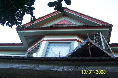

Finishing the "fun" gable over the front door -
Edited 10/31/2008 9:03 pm ET by McDesign
Missed a spot.
