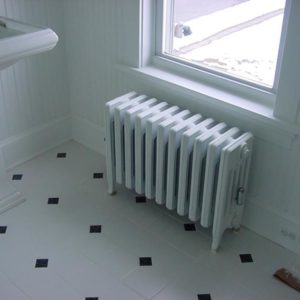

      That's not correct. Steam radiators may get too hot to the touch, but never get to 200 degrees, or have a direct flame on them that high heat paint is for.  So, regular rustoleum is fine, has lasted for years on several of my radiators that have been stripped (not by spending $500 at a shop for sandblasting either), and comes in more colors than black, white, grey, and tan.
      Many people waste money on powder coatings at the auto body shop after having them sandblasted. The heavy powder coatings would obscure the linework cast into the fins of older radiators, defeating the point of stripping them in the first place.
