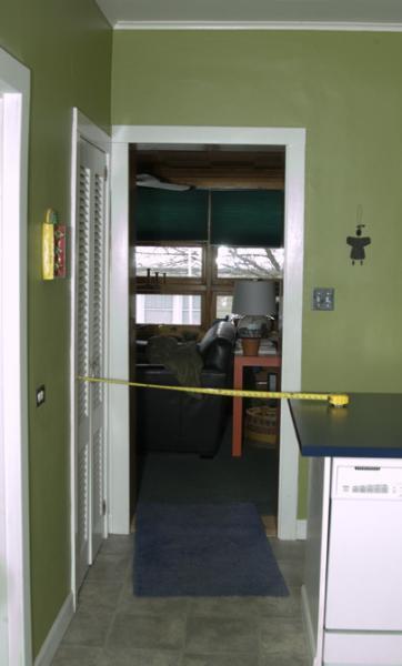

This pantry has bugged my wife and I since we purchased this bungalow five years ago. Just to be clear, this layout is as we bought it: we have not made any changes at all. Let me explain the images first.
Kitchen Pantry Door_1
This is our view from the center of our kitchen.
Kitchen Pantry Door_2
Same view but different angle.

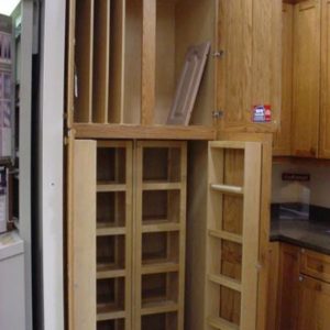

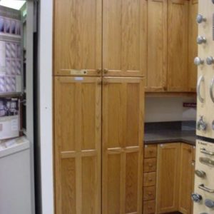

    Don't know if this might interest you or not but the other day I snapped some pics of this shelving design.
    Thought to custom fit one myself out of maple into an odd interior wall setting.
    Liked the idea of it's space maxing capabilities.

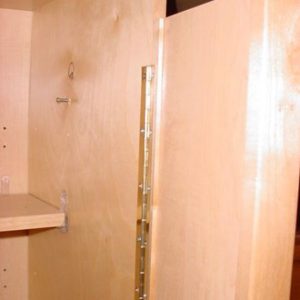

      I've never seen anything like that before. I really appreciate your post.I have used piano hinges in the past so that would not be new to me and having to just have two doors as opposed to four is appealing. I'll give this some serious thought.Again, thanks for your post.

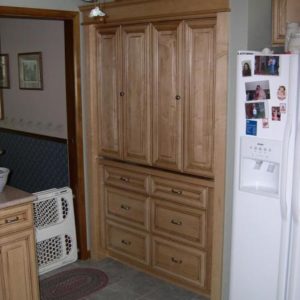

    Built lots of pull-outs.  The 55" depth is the problem.  Maybe you could frame a closet on the other side.  Accuride makes a 28" #91976, or a Rockler #31797.  The wheel idea may be good, with a center guide at top if you don't want to use the other side.  I built these for our kitchen, using the Accurides, and they hold a lot of canned goods.
      PhillipB | Jan 29, 2008 03:54am | #30
      Tom,Thank you very much for your post and the picture.Your photo is what I'm seeing in my mind's eye save for the fact that mine will be about 79" in height, 36" deep, and each pull-out will be about 9.5" in width. The casters will probably be needed to help support each pull-out at full extension.Someone earlier linked me to some 36" slides from Rockler that will do the trick to finish it off, so I guess I'll have to shell out the bones for the Rockler's if I want to eat my meals on a plate rather than a bowl with Fang down in the basement.Just to be clear, the back side of this pantry is a common wall for my wife's office storage space or closet.I would like to know your spin on these tall and deep pull-outs based on your experience and what my plans are. If I'm missing something here, I'd appreciate your comments.Regards.Edited 1/28/2008 10:48 pm by PhillipB

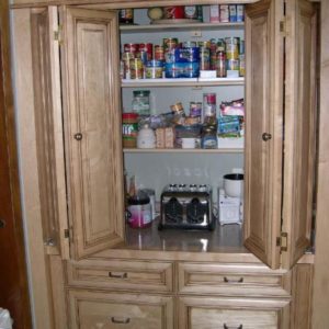

        Our pantry is only 30" deep, and designed to fit, so a little easier situation than yours.  Still, I did the same as suziekitchen suggested.  I didn't want to waste a bunch of space on brooms, so here's what I did:
        For the shelving part I wanted separate shelves so I could see in from the top as well as the sides.  Also a whole lot lighter than pulling out a bunch of joined together shelves.  We have been very happy with the results - very efficient use of space, smooth & easy to use (Blum Tandem glides).

          Thank you very much for your comments and the nice photos. I do like the broom pull-out. Very nice indeed.I have to say that our pantry seems very limited in real world options. I think it just has to do with the whole house in general. It's a Chicago bungalow, 90 some odd years old and the whole layout seems to scream, 'Don't change me, don't change me!' and that drives me nuts. I look at your pictures and everything seems to just fit together very nicely. If you look at the images that I have posted you may agree with what I'm saying. Or not.I really like the horizontal wire baskets that you have installed. I don't believe those would be feasible in our case, unfortunately. All of our volume is in the depth of the pantry, so our pull-outs have to be as deep as possible, and wide and deep would, I think, be too heavy which is why I'm looking hard at the vertical shelves. If I can locate wire baskets in that configuration, then I will give them some serious thought. I do agree that you can see stored items much better with the baskets.I really think that, going back to what I said above, we have to keep the 'look' of our kitchen in check with the overall theme that presently exists and as you've seen from the photos, I'll have to try and keep the louvered door look in my final design to keep the present theme as uniform as possible. Having said that, the louvered doors will lend themselves very nicely to the vertical pull-outs as opposed to the horizontal configuration.Again, thanks for your post.
