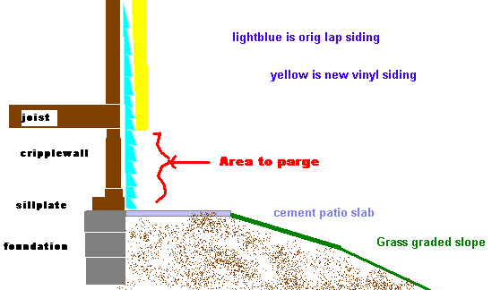

Please see the attached picture.  (NOTE:  This is NOT my house…. someone asked my opinion).
Situation is this:  Block foundation,  then sill,  then cripple wall of approx 18″,  then floor joists,  then wall.  House has original wood lap siding down to the sill plate.  Outside grade is right up to the sill plate with a cement patio right up against the foundation.  The house has now been vinyl sided from top of cripple wall and upwards.  At some point in past,  the cripple wall area downward,  still with wood lap siding, had a wire mesh cement “parging” or stucco applied.  That area has crumbled and has been removed,  revealing the lap siding.  The homeowner wants to re-stucco or cement parge this area.
Can cementboard (like for bathroom tile work) be applied there and then cement parging be applied?  What kind of mix should be used?
I know,  I know.  This is not a “Fine Homebuilding” situation.  I told them that the grading is too high and should be below the sill,  and that the siding SHOULD have been applied all the way down to the sill.  But they dont have the money  for the regrading.  They bought the house this way. This is what it is –  whats the best thing for them to do to cover back that cripple wall?  They WANT the look of that area being cemented as if it was the foundation.

    Nice pic...or should I say diagram.

    I've got to say as well, nice sketch. What program did you use to do that?

      I created the diagram with MS Paint.  Just used my "calibrated" eyeball-to-mouse-hand coordination.  Saved it as a small ".gif" file (as opposed to Paint's ".bmp" default which makes a HUGE file),  cropped just the sketch area.
