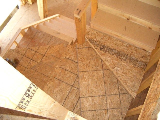

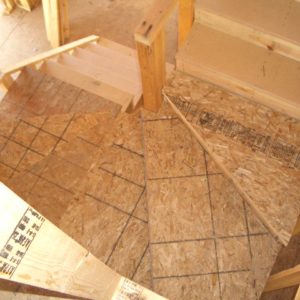

I used PB treads on this stairwell, and after the pictures I covered them with cardboard so they wouldn't swell.

Nice winders.
Can you please take a couple pics - from below - to show how you framed or cut the risers in the winder zone?

They are just a series of boxes stacked on top of each other,
I don't have any pictures from underneath, I can probably get some this week.
3/4 with a top of 1/2, both Advantec covered with carpet and all is OK to date. Lots of PL 400. Cows would not hurt the staircase.
The temps were torn up prior to install. I expect these to last longer than me.
