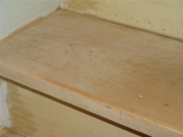

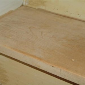

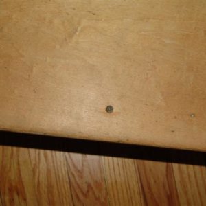

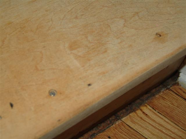

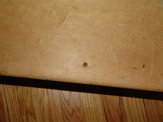

As you can see in the photos, at some point in the past the treads have been screwed to the riser with drywall screws, 5 per tread. The heads are countersunk about 1/8″ to 1/4″, and the wood has expanded around the head so that backing the screws out creates “mushrooming” and splinters the tread around the hole as the screws comes out.

    jagwah | Jun 24, 2006 04:52am | #1
    From the looks of the steps just fill them and paint it all.
    There is nothing there of value to stain. Looks like it might be poplar or birch, maybe. At best just fill it and faux finish it to like whatever wood you wish it were.
    For no more effort you'll spend more money farting around with it then just redoing it altogether. MHO
