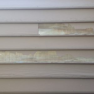

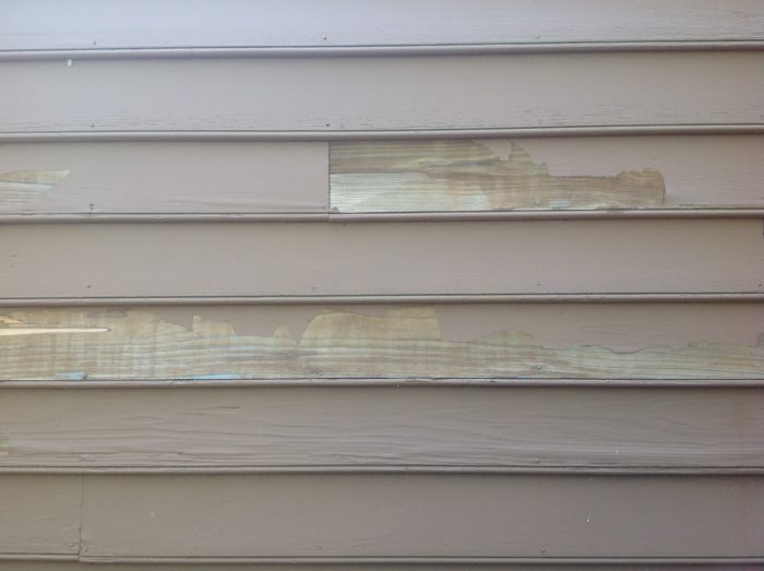

  6. Erika23220 | Sep 28, 2012 07:46am | #8
    Picture of Siding
    Here's a picture of the siding in question.
    Thanks,
    Erika
    1. calvin | Sep 28, 2012 07:55am | #9
      erika
      It looks like the end cuts were probably not sealed (seldom are but a real problem cause-er.  Many times the topcoat paint will fail, leaving the primer.  Doesn't seem so in this case-no primer showing.

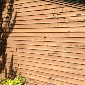

      1. Erika23220 | Sep 28, 2012 09:37am | #11
        Siding Whole Side of House
        Here is a picture of one side of the house.
        1. DanH | Sep 28, 2012 08:22pm | #14
          On the bright side, that paint's so loose you could scrape off most of it with a kitchen spatula.  Loose enough that scraping and repainting may be worthwhile, actually.

    2. DanH | Sep 28, 2012 08:29am | #10
      Yeah, if a primer was used, it was tinted to match the topcoat -- I can't see any hint of white anywhere.  My guess is that a "one coat" paint product was used.
      Sometimes a "factory primer" will be used, and that is apt to fail on either side.  But in this case it appears that there was no primer at all -- the paint was put over raw wood, a very bad thing to do, (despite what the paint companies say).  (I don't see any evidence that the joints are a particular issue, though certainly the ends should be primed before installation.)
      A good alkyd primer, topcoated with a good acrylic latex, will essentially bond to the wood forever (and longer, if the wood is back-primed).  The only reason the surface would need repainting in the future is that the surface of the paint slowly erodes over time.
      (One thing to determine about this contractor -- is he going to prime the wood, or just paint over raw wood again?)
