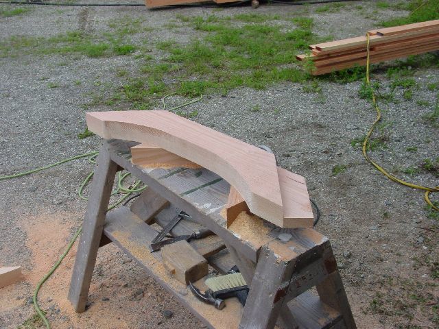

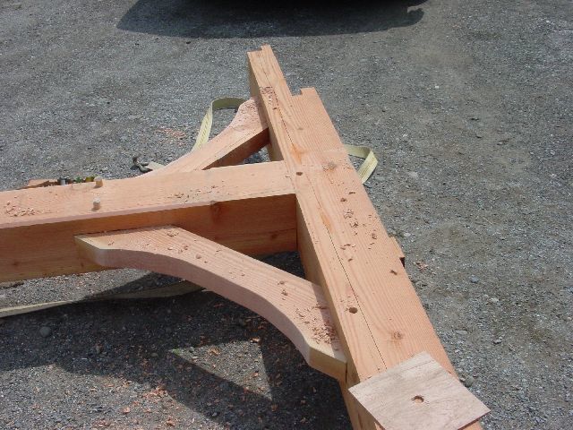

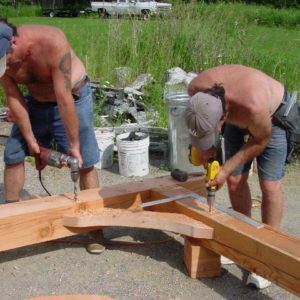

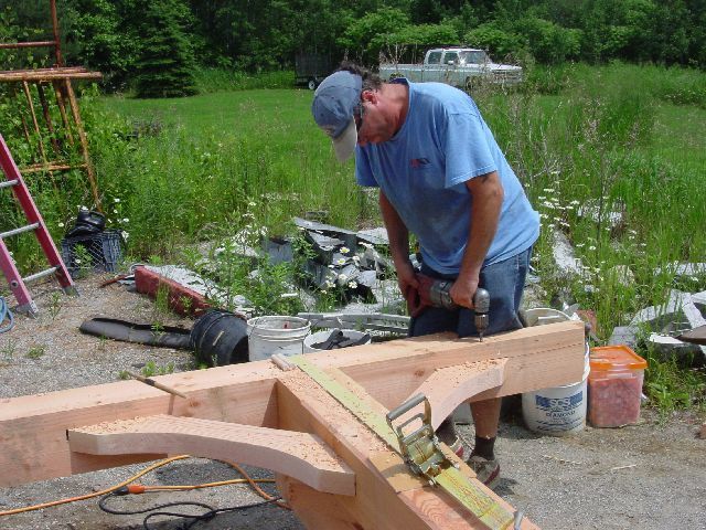

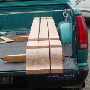

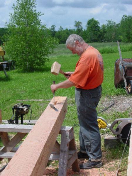

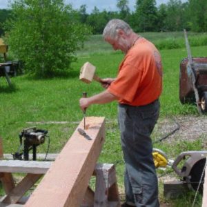

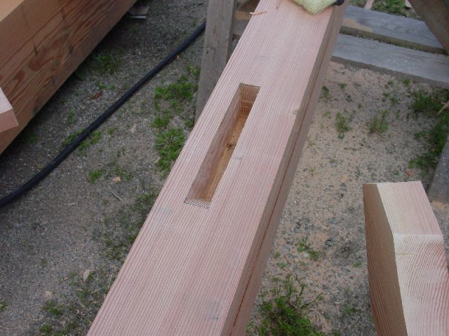

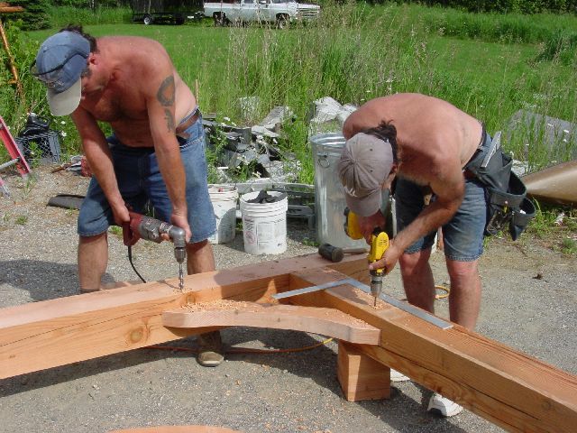

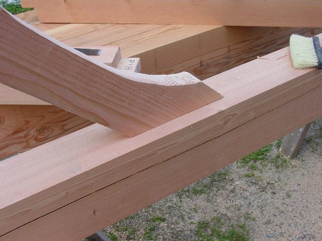

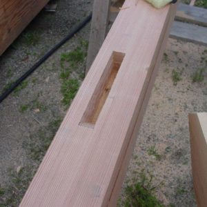

After seeing the cover article a few months back ,my dear wife thought we should have one to shade our South facing glass from Summer solar gain as well as a place for vines to grow.
My good friend is a highly skilled timber framer who agreed to construct this unit from Douglas fir      Alfred Bourgoin   DBA  Dovetails Plus.
Work is in progress   some pictures to show his workmanship.

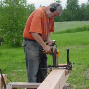

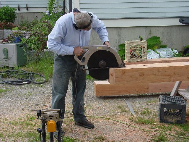

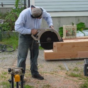

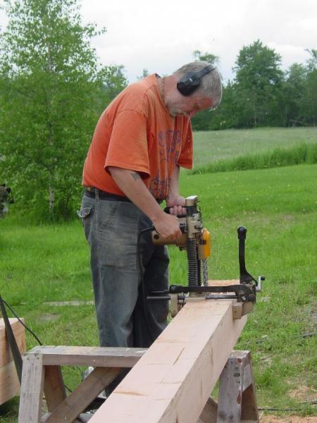

  4. DougU | Jun 16, 2006 03:25am | #7
    Looks nice, keep the pics coming.
    Whats that machine the guys using?
    1. jesse | Jun 16, 2006 04:28am | #9
      It's a chain mortiser.
      1. DougU | Jun 16, 2006 05:02am | #10
        I knew it was a morticer but what brand/kind?
        Price would be nice to.

        2. theslateman | Jun 16, 2006 01:06pm | #12
          Doug,
          I'll look today to find the brand-I think it might be Makita but not sure.
          It works like a charm for him though.

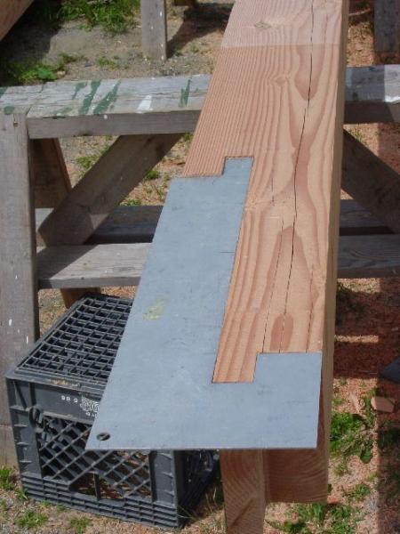

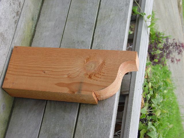

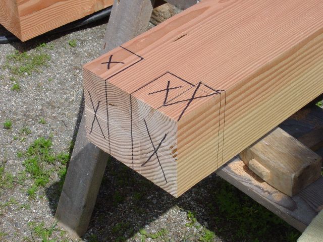

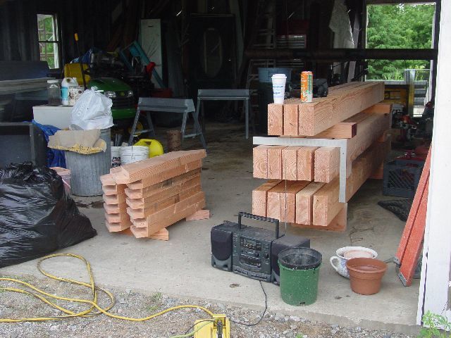

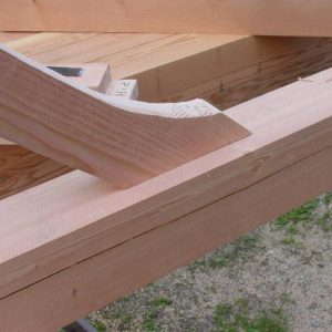

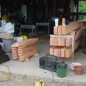

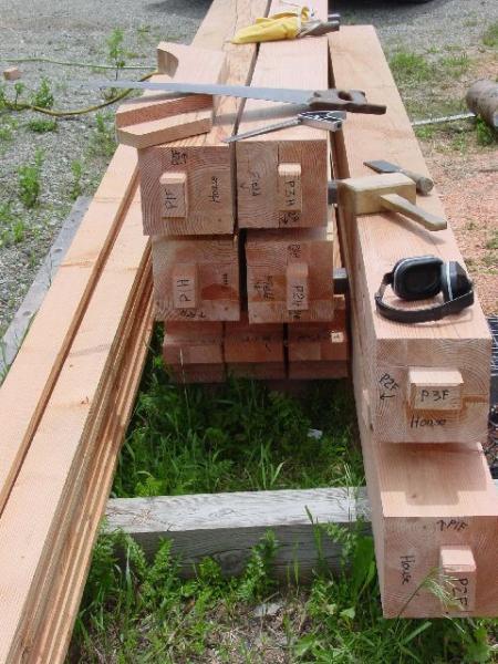

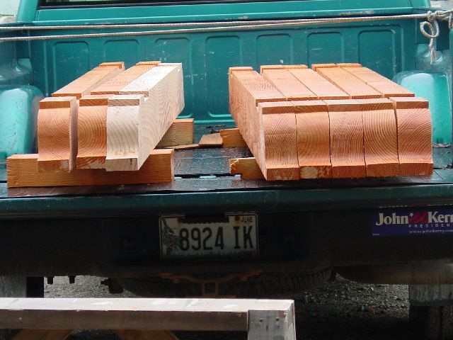

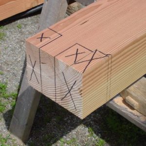

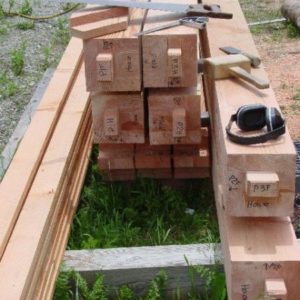

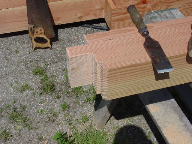

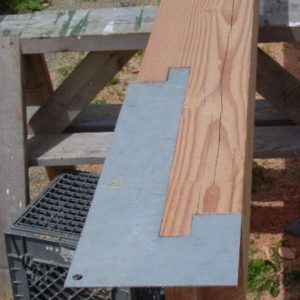

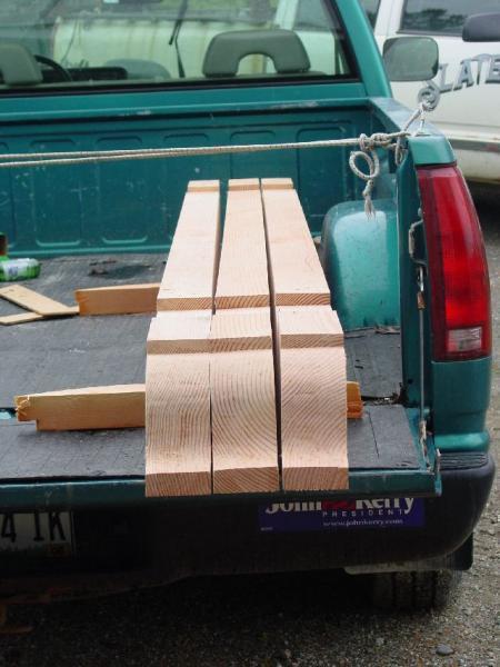

          1. theslateman | Jun 16, 2006 02:39pm | #14

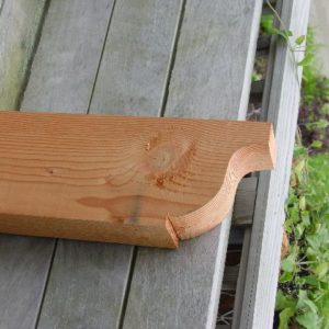

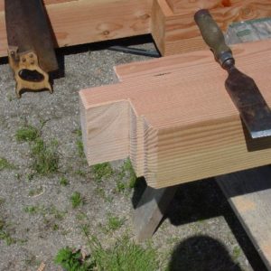

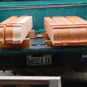

            More pics of the beam work in progress.
            Pic 75 shows the mock up for the cross beam ends which will extend a foot beyond the main beams.
            Pic 82 shows the scarf joint used to join the long top beams.
            The whole structure will be 10' x 24'. The 5/4 laying off to the side innnn the stacked beam shot will be used on top of the ogee end cross beams.

        4. theslateman | Jun 17, 2006 01:52am | #17
          Doug,
          It's made by Makita-but it's not blue!
          The cost is around $1500  -Our local Makita rep,who I saw today  at an open house for tools and such, said there seems to be a lot of sales of these lately. I'm near Bangor,Me.  and he probably covers the whole State.
          1. DougU | Jun 17, 2006 02:52am | #18
            Thanks Slate
            Looks like a cool tool, wonder if  I could justify one!
            Keep the pix coming, looks to be a neat piece when its done.

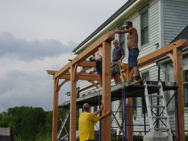

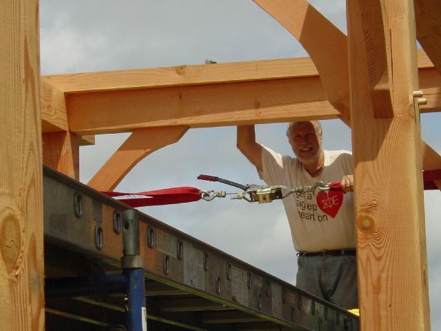

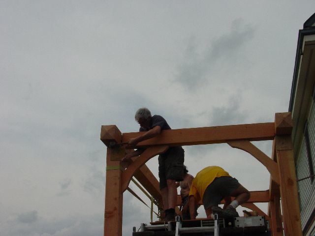

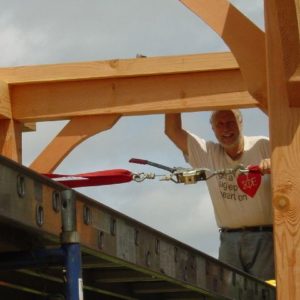

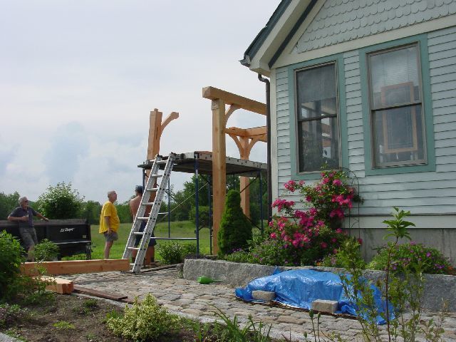

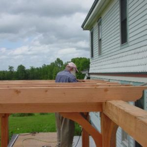

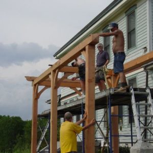

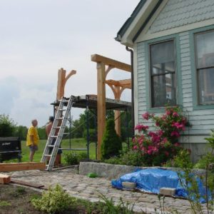

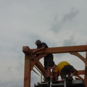

        1. theslateman | Jun 24, 2006 12:37pm | #20
          Here are some more shots of the pergola that my friend is building for my wife and I.
          His friends(also contractors and timber framers helped with the raising)
          I'm thrilled with the quality of his workmanship-I think you'll agree!
          1. DougU | Jun 24, 2006 11:44pm | #21
            Slate
            Bout damn time! :)
            Besides Mike Smiths and Stans threads yours is one that I egerly wait for.
            Thanks, its looking good.

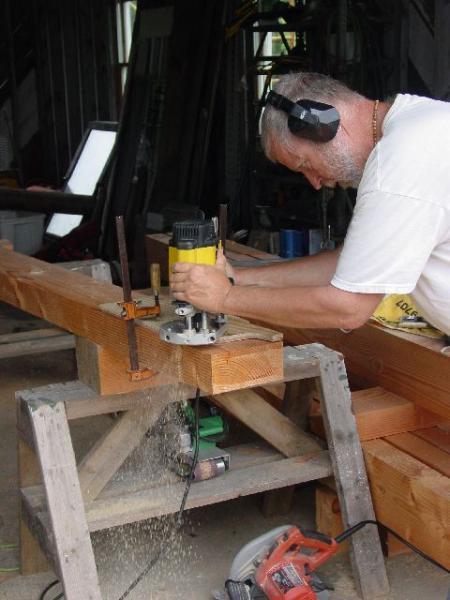

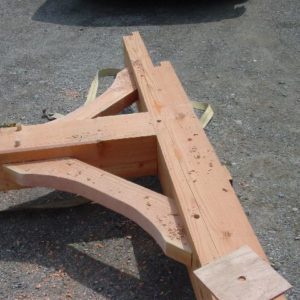

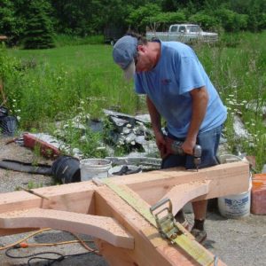

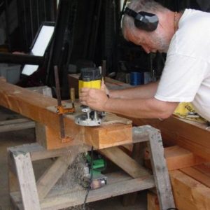

          3. theslateman | Jun 27, 2006 01:03am | #23

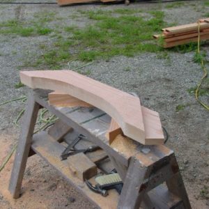

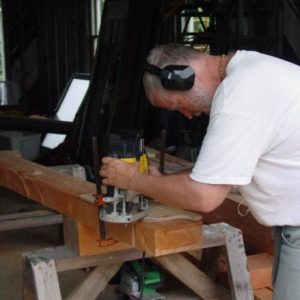

            More pictures of work in progress.
            Check out the router set up for the ogee profile on the cross beams.

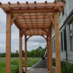

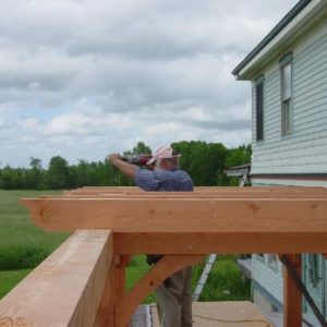

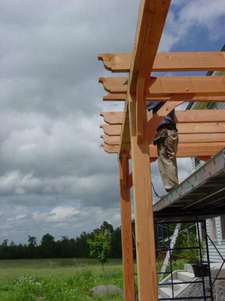

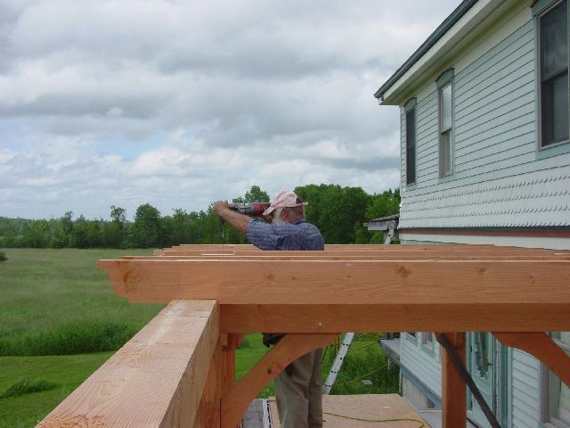

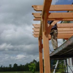

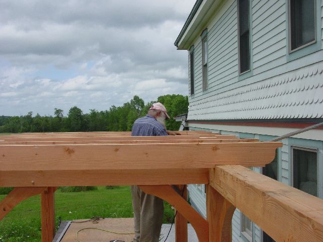

          4. theslateman | Jun 28, 2006 12:25am | #24
            Today the ogee end cross beams went up.
            The frame and braces are complete.
            Tomorrow the 5/4" x 4" is screwed down to the croos beams  with 2 1/2" stainless screws -staging taken down and start growing some vines on it.

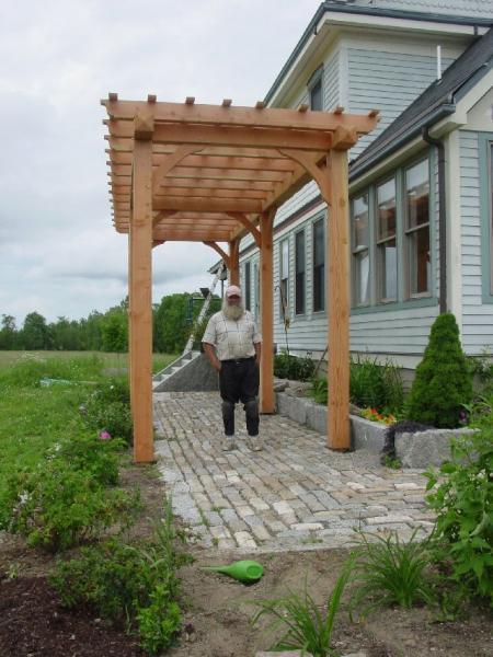

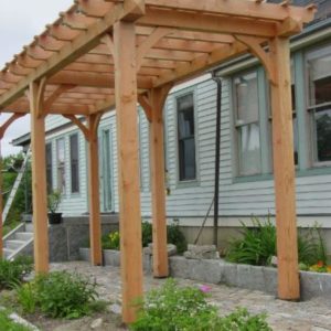

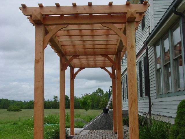

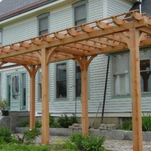

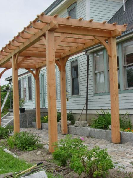

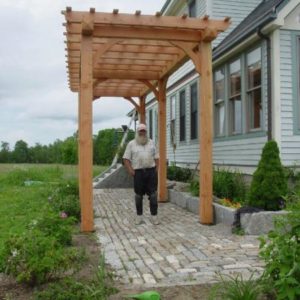

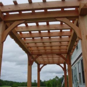

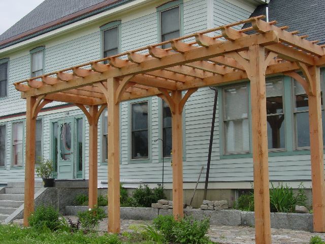

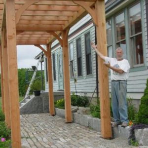

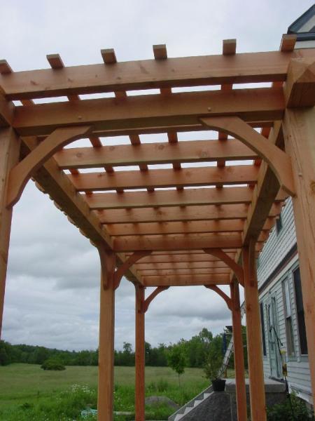

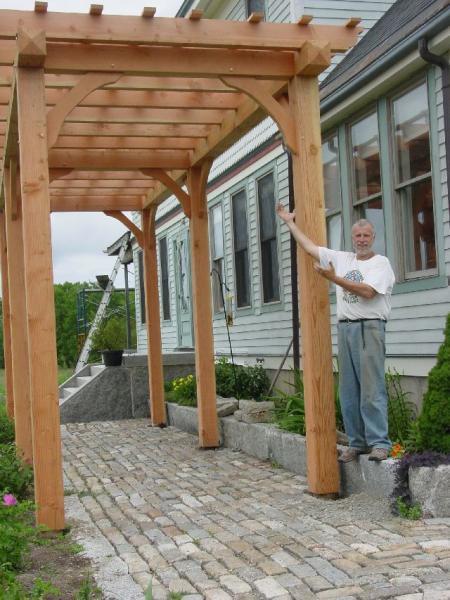

      1. theslateman | Jun 28, 2006 08:58pm | #27
        Justin,
        Alfred has completed the douglas fir pergola as a stunning addition to  our home.
        You asked to see pics of the finished unit-so here they are!
        The man wearing the pink hat is the slateman.
        Edited 6/28/2006 2:00 pm ET by theslateman
        1. johnharkins | Jun 28, 2006 10:50pm | #28
          Newburgh looked in my NatGeographic Atlas and couldn't find you after 45 seconds - you near the 45th parallel?
          beautiful addition to your smashin house and aspect
          what you going to grow on that to help take the squint outa your eyes lookin over that meadow?
          I built a screen/storm door muy similar to that a few yrs ago /close to as fine as yoursthat fir in the ground treated w/ some of your roof tar or something I hope
          1. theslateman | Jun 28, 2006 11:34pm | #30
            John,
            Newburgh is just South of Bangor-home of horror writer Stephen King,yes near the 45th parallel.
            Thanks for the positive feedback.Planting the vines and such will be my wifes chore.We'll also add some hooks for bird feeders and hanging potted plants at strategic locations I think.

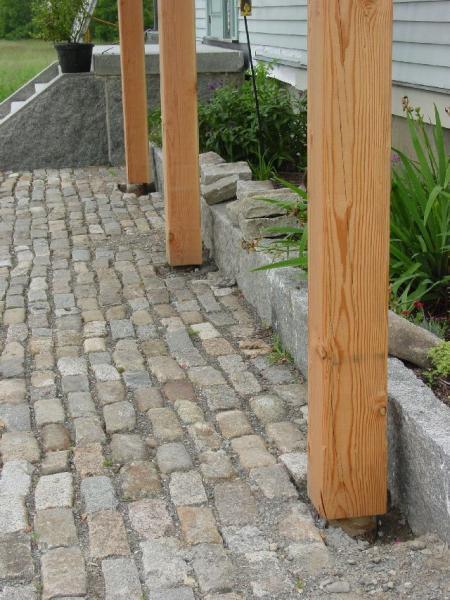

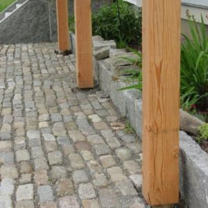

            The post bottoms are just above ground level,sitting on poured sonotubes.
          zak | Jun 28, 2006 11:18pm | #29
          That pergola looks great.
          Is it going to get some stone feet at the bottom of those posts?zak
          "so it goes"
          1. theslateman | Jun 28, 2006 11:41pm | #31
            Zak,
            You probably noticed all the granite paving blocks,retaining wall slabs,and large set of granite steps.
            I'll be filling in the paving blocks to just come up next to the posts-but they will remain an inch above the walkway on the inside and garden soil on the outside.
            Aren't you the fellow who does a lot of stonework? I've still got a large retaing wall to build with granite 30' to the left of the pergola.It's probably 80' long and it will be 4' to 5' high.Luckily I've got most of the product on hand-all recycled stone.
          2. joewood | Jun 29, 2006 02:20am | #32
            Hey slateman, did you ever tell us how the posts are attached at the bottom?Plan to put a sealer/finish on that beautiful structure?
          3. theslateman | Jun 29, 2006 01:02pm | #38
            Each 6"  sonotube has a 3/4" stainless rod projecting up 4" to accept the hole bored into the bottom of each post.
            Hadn't planned on a finish but I'm open to suggestions.What would you use for this?

          5. bww_maryland | Jun 29, 2006 04:37am | #35
            slateman, absolutely beautiful!  Not sure if I'm more impressed w/ the pergola or what looks like endless land w/ no neighbors... i'd like to have both.
            bww
          6. theslateman | Jun 29, 2006 12:55pm | #36
            Having those 15 acres out back and no close neighbors on any side make for a wonderful retreat after work.
            Lots of birds and wildlife too. Thanks for the kind words.

        3. DougU | Jun 29, 2006 02:58am | #33
          Slateman
          Very nice, very nice addition to your house.
          1. theslateman | Jun 29, 2006 01:03pm | #39
            Thank you very much Doug.
        4. MikeSmith | Jun 29, 2006 01:09pm | #40
          great !.. i like this pic... can you back away for a 3/4 view ?
          1. jesse | Jun 29, 2006 06:08pm | #41
            I wouldn't put finish on it. Let it turn silver. I built a deck for my inlaws last summer (all cedar, with the railing system timberframed with free tenons, etc) and already sincerely regret putting a finish on it. Damn I am a moron. Never again.
          2. butch | Jun 29, 2006 09:24pm | #42
            But his pergola is out of fir or spruce so I would,even if is somethingthat is a clear finish or close facsillimeIt would be a big shame to see this start rotting within a coupleyears.
          3. Snort | Jul 07, 2006 01:34am | #43
            Nice complement to your house. Albert does purdy work...it sure would blend in nicely all silvered.Did you build your place, or is it old? What is on the 1st couple feet of the eaves? And, those 2nd story window heads are very tasteful.Thanks for the show<G> I need a dump truck, baby, to unload my head

          5. clarkfam | Aug 10, 2006 04:56am | #45
            very nice. I like the cobble stones, where did you get those? are they salvage. I would also like to know where you picked up those beams. I'm in readfield, maine.
          6. theslateman | Aug 10, 2006 01:01pm | #46
            Thanks.  Yes the cobbles are all salvage from the streets or Railroad yard in Bangor,Me.
            The beams are Dougb fir that come East in boxcars to Viking Lumber in Belfast,  Me.-and are then resawn to size and length you need.
