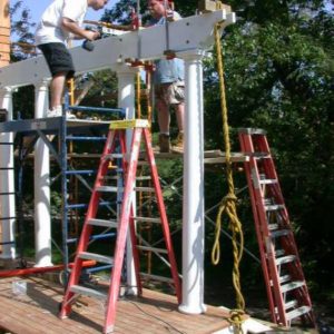

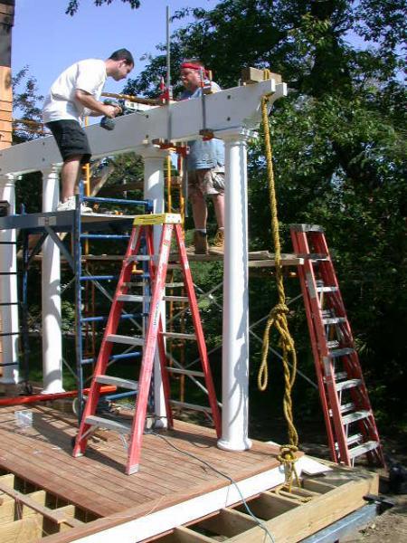

          here's 4x4 PT, with fiberglass columns & PT pergoal capMike Smith   Rhode Island : Design / Build / Repair / Restore

          2. Piffin | Aug 02, 2003 06:07pm | #8
            Mike, could you speak about the windlass? I understand but this is a DIY thread here....
          3. xMikeSmith | Aug 02, 2003 06:27pm | #9
            well, when (2) 2x12 PT  caps decide they want to do one thing, and i want them to do another, we eventually resort to force..
             Roy said i'd never get them into alignment, but i thot otherwise and ran a tight loop over a block on top and the main beam framing the deck on the bottom..
             a couple twists with a stick in the loop persuaded the cap that it would like to sit on top of the last column..
            anyways .. i don't know if this is the proper terminology ( windlass ), but it is something i've used in the past in planking boats and other persuasive occasionsMike Smith   Rhode Island : Design / Build / Repair / Restore

            The thing I found interesting is that since this is essentially a freestanding wall, it becomes a tensioned system when the top is yanked down like that while the fasteners are hooked up. To some degree anyway, that stabilizes things..
          6. xMikeSmith | Aug 02, 2003 08:46pm | #15
            piff.. another interesting point is when the tension on the "windlass" was released.. what happened ?
            did the 2x12's revert to their original shape and pull the 4x4 post out of the ground ?
            i'll never know.. at that one point in time i did have all 4 posts in alignment and got them all double bolted... but your  tensioning point does raise some possiblities for the future..Mike Smith   Rhode Island : Design / Build / Repair / Restore
