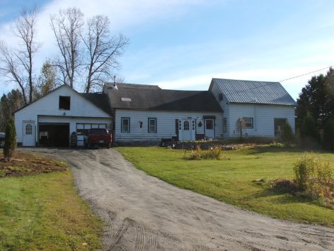

      KiddervilleAcres | Oct 27, 2008 05:16am | #13
      Thanks John,
      Here's a pic of the house.  Yeah I know, it needs a lot of work but that's OK wit me.
      Just installed the two doors with the arched winders, added sidelights to the one on the right.   The old door (far right in the center section of the house) is going away.
      The pergola will run from the section of the house with the metal roof, come out 10' then 20'  to the left side the window to the left of the door with the sidelights.
      I see where your idea might work.  Just not sure how it will be when it snows though.  Gettin the snow off the roof 'tween the crossmembers might be a challenge.
      Regards,Bob @ Kidderville Acres
      A Woodworkers mind should be the sharpest tool in the shop!
      1. JohnFinn | Oct 28, 2008 04:48pm | #14
        The method I was describing would not be entirely water-tight, but I don't think it would have to be for the use you are describing? (due to the fact that you would be placing the panel sheets between the pergola cross members). What direction does the front of your house face? Below is a span chart for manufacturer of the panels.
          KiddervilleAcres | Oct 29, 2008 05:13am | #15
          John,
          The front of the house faces slightly west of north.  It gets late afternoon sun.  Looking at the chart I would guess the corrugated sheets would be stronger than the ones I had in mind.
          Snow if my biggest concern as ther easily could be 2' on the roof at times during winter up here.  I'm in NH ~ 10 miles from Canada.
          I've never built a pergola before but am thinking of spacing them 16" OC.  The ends would be facing the street, flat not pitched.
          I thought of pitching the roof on top of the crossmembers with additional framing under them, as the house sits up quite a bit from the street so it wouldn't be that visible.
          Did you see the pic I posted of the house?  I took that from the bottom of the driveway in the picky.
          Regards,
