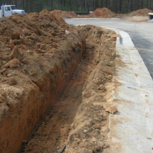

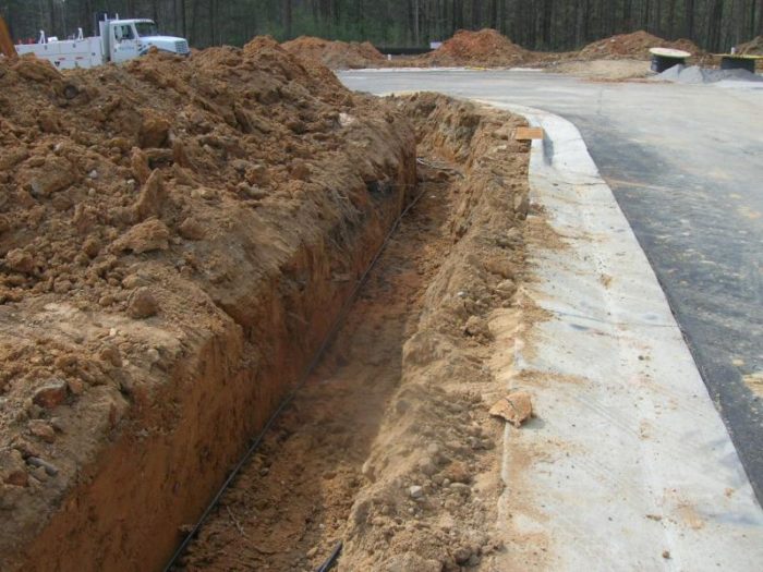

        Matt | Oct 06, 2008 03:04am | #10
        >> But do the phone and electical need to be 2' apart? <<
        Not sure.  That is just how they do it.  As you said, they aren't going to dig a wider trench then they have to.   See attached pic.  One  variable is in the backfill.  If there is a lot of rock in it they will either cover the lines with screenings (gravel sand) or put the cables in conduit, depending on which is available.  If they hit solid rock and the trench can't be ~2' deep, then they will put the power in conduit.  Or, if the power cable is to go under pavement, then conduit.  They don't use conduit, for the most part, except for the previous reasons.  Another way to get the separation between the different dry utilities is by layering the trench.  When I've seen it done, even for fiber they wanted the cables separated.    They have only been doing joint trench around here for about 3 years.
        Sometimes, Time Warner, the local cable company, will have them bury conduit with rope in it and then they pull their coax later.  Maybe they do this so they can upgrade to fiber later?  That is for mains though and it is coiled conduit.  The power goes in rigid 10' coundits.
        If you want more pics I have them, but most of are of main installs.  The services aren't that interesting....
