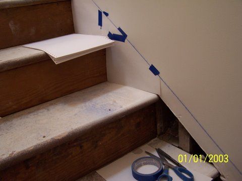

First, I snap a line at some arbitrary distance from the tread nosings – here it’s about 2-1/2″. This will be the top of the skirt. Then, working from the top, I cut and fit pieces of printer paper (old cases of fan-fold) to each triangular space.
Fit the bullnose, slide the paper back, taper the riser line if it’s not vertical, and mark the paper where it crosses the snapped line – cut it along the line joining the marks. NOTE – it’s important to match the chalk color to the tape color – (actually, blue chalk can be painted over). Use the offcut triangle to fill in and strengthen the gap.

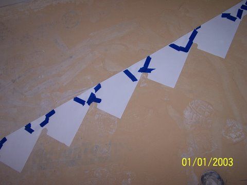

Carefully cut through the tape bits holding the long pattern to the wall, and lift off your 14′ pattern piece.

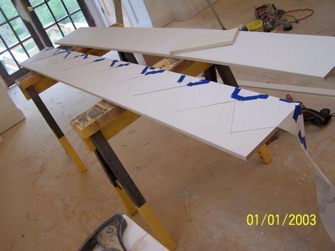

Tape it to your skirt material (here, two pieces of MDF 1×12), and trace it. Don’t worry, it’ll have an oak trim cap that wraps the weak MDF top edge

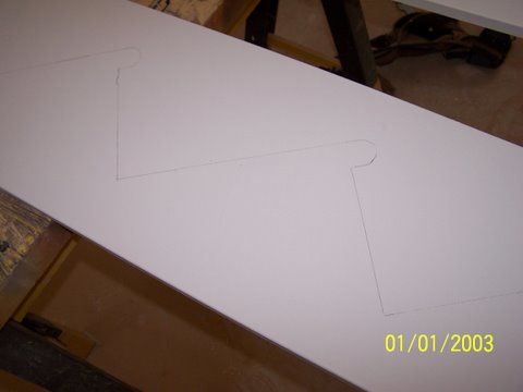

Here are the cut lines, ready to go – no trimming and fitting required. The “good” side is on the top.
