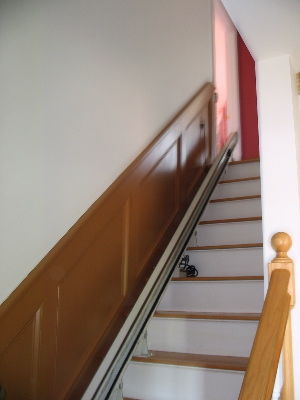

    As long as you bisect the angles, the profiles will match. The only problem is that the angles may exceed the swing of your miter saw. You have to make a jig to hold the moldings on the saw. In figuring your angles, you stay parallel with the stair and go plumb/perpendicular to the skirt. Hold the molding on the marks, mark the two edges of the moldings, where they intersect and bisect that angle. The smaller angle will be a compliment to the steeper one. I only have one poor picture. There are no panels, just sheetrock, moldings and paint.

      JFink | Feb 06, 2008 05:37pm | #6
      Bisecting the angles, that's the key that I wasn't thinking correctly about when I pictured the problem in my head. Thanks.Justin Fink - FHB Editorial

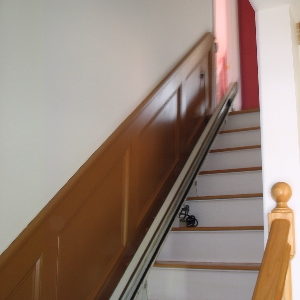

    I did as someone else mentioned, draw the whole thing out on the wall first, bisect your angles and make the cuts, that simple. Another thing mentioned, sometimes the cuts cant be done without some sort of jig for your chop saw, easy enough to make.
    These steps and their wainscoting(pictured) have a sweeping curve to them so all the boxes are different, consequently all the angles change,  takes a long time but having the drawing on the wall really helps, that and the Bosch angle finder!
    these pictures were scanned so clarity is non-existent.

      JFink | Feb 06, 2008 05:38pm | #8
      nice stiles/rails...and the curve looks terriffic. What materials did you use? MDF? FJP?Justin Fink - FHB Editorial
      1. DougU | Feb 07, 2008 03:42am | #10
        nice stiles/rails...and the curve looks terrific. What materials did you use? MDF? FJP?
        All the curved stuff is some sort of flexible moulding stock, same as the curved crown that you see from time to time, I'd have to take a look to see what brand, been awhile. Feels like a really dense rubbery/plastic sorta stuff ( I think that's the technical name for it! ) It does machine well, we ran that panel mouldings through the Wienig and it came out great.
        All the strait stuff is just poplar, we never use finger jointed pine, not sure why but I think we get pop fairly reasonable.  The flat panels are 1/4" mdf.
