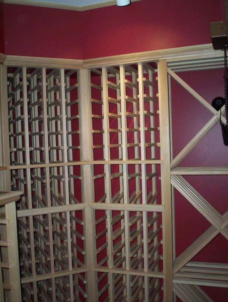

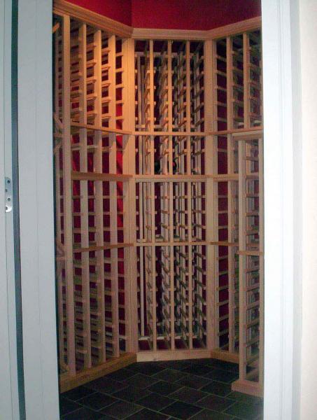

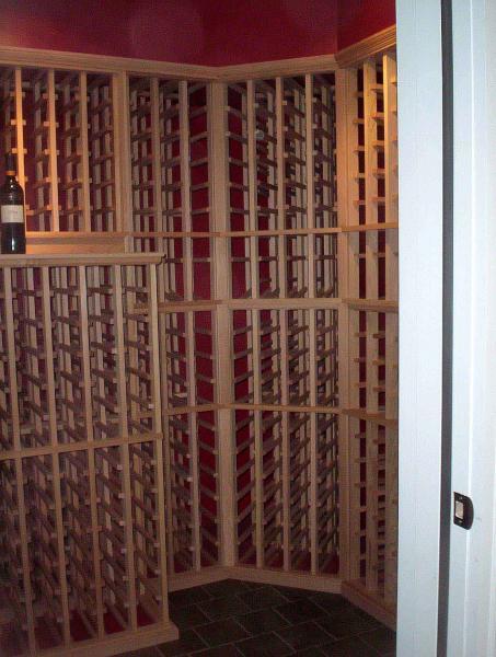

I just finished a wine cellar (1000 bottle) and can’t get good pictures because it’s so small. Does anyone have any suggestions on how I can get better pics? The room is 7 x 10 and floorspace is under 35ft sq.
Some of the better pic’s attached, but you miss a lot. This is my first cellar, an apprentiship of sorts, and hopefully more to follow. That’s over 3000 pieces of cedar, a lot of nails and a whole lot of sawdust. Not a bad first attempt. Oh the things I’ll do different next time……. but isn’t that always the way?

Thanks for the complement Forrest. The racking is all "home grown". A friend of mine built a jig for making them and now it's time for me to upgrade it a bit. The side and corner racks are 19 bottle with the 12th one for display. The centers are 20 bottles, no displays and the side x-racks are made from the left overs from one operation. Time consuming but efficient. That display table and 2 rows deep were firsts. The guy I did the room for got hung up on having 1000 bottles in the space. The only way I could accomidate was to go 2 deep there and in the back of the corners. I ended up with a bunch of extra filler in the front but I think it came out ok. In the end he should be able to rack 1018 bottles give or take.
FatRoman - first, nice quote. Had to look it up to translate but I like that one..... The room is ~ R-40 walls and ceiling with a 10 mil vapor barrier and a windowless outswing exterior door that I cut down to fit under the steel beams they had in the house. It's away from the exterior walls so it should be less effected by winter temp swings. For room air conditioning, I used a whisperkool 3000. I've heard mixed reviews on them but I have a feeling that most peoples bad experiences come from having an undersized unit. Everyone likes to show off the space with glass and they forget to upsize the unit to compensate for the lost R value.

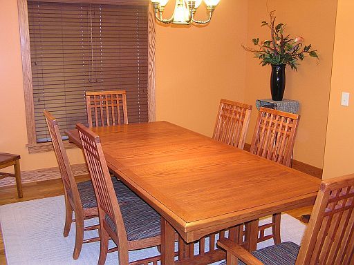

As for the camera...I sell houses, and use a Canon SD870. It's got a wide-angle lens (28mm equivalent). There are some digital cameras that have even wider-angle lenses on them. For laughs, I just took a shot from the same place of my dining room with the Canon and my old Olympus C740UZ (38mm equivalent, which is what many cams have). You can really see the difference.
