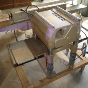

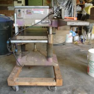

    Fonzie | Jun 06, 2006 07:00am | #15
    jamar hammer,
    I wanted to get the pics here sooner, but had to clean some embarassing rust off, get it on the job, etc. Sorry. I think I told you last week.
    Well, here it is. It has proven to be a good tool. Notice the "anti-theft" "Federal Safety Purple".
