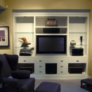

Thought I’d show my most recent cabinetry. This entertainment center houses a 42′ plasma t.v. that rolls out on two 150# full extension glides for back access. The upper row of drawers holds 900 cd’s, about 2/3 of the clients collection. The middle bottom is a subwoofer, big sucker.
Finished this Friday night at 8 pm.

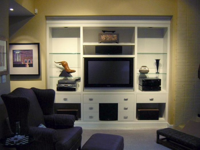

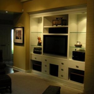

          jagwah | May 04, 2004 06:15am | #8
          Thanks for the comments. The whole thing start to finish took me about eight days. The sides are 16" deep with 3/8" tempered polished glass shelves. The center is 24" deep. The plasma is mounted to the front of a drawer basically. Imagine a 5" deep drawer with a face 38"  high. The glide is a 150# rated full extension 18" deep. This allowed for the 5 1/2" depth of the plasma to set back flush with the front of the cabinet.
          I kid you not I was sweating bullets when we mounted this puppy and rolled it out for the first time.
          The drawers across the middle has inserts that hold the about 2/3 of the clients cd collection, 900. Man I gotta a lot of cd's but not that many.
          The dark center is a big honkin subwoofer.
          Here's what they had before..   and the next is a after.

            I like how you extended/ deepened the side bays and applied a continuous length of crown moulding above. Great idea regarding mounting the unit on a drawer face, but why 31" tall? Could you have installed the drawer at mid height instead, or would that have caused too much wobble?
            How does the unit pull out? I did not notice any type of pull. Is it the reveal below?
            Nice job!
            F.
            jagwah | May 25, 2004 12:14am | #11
            Sorry for the slow responce. The high face on the drawer was due to the spacing of the four mounting holes. To hang this puppy by the top two might allow for the unit to tilt somewhat.
            As to pulling out the design of the screen allows for an edge your fingers can easily pull from.
