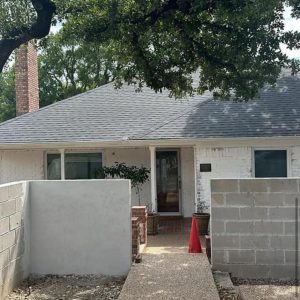

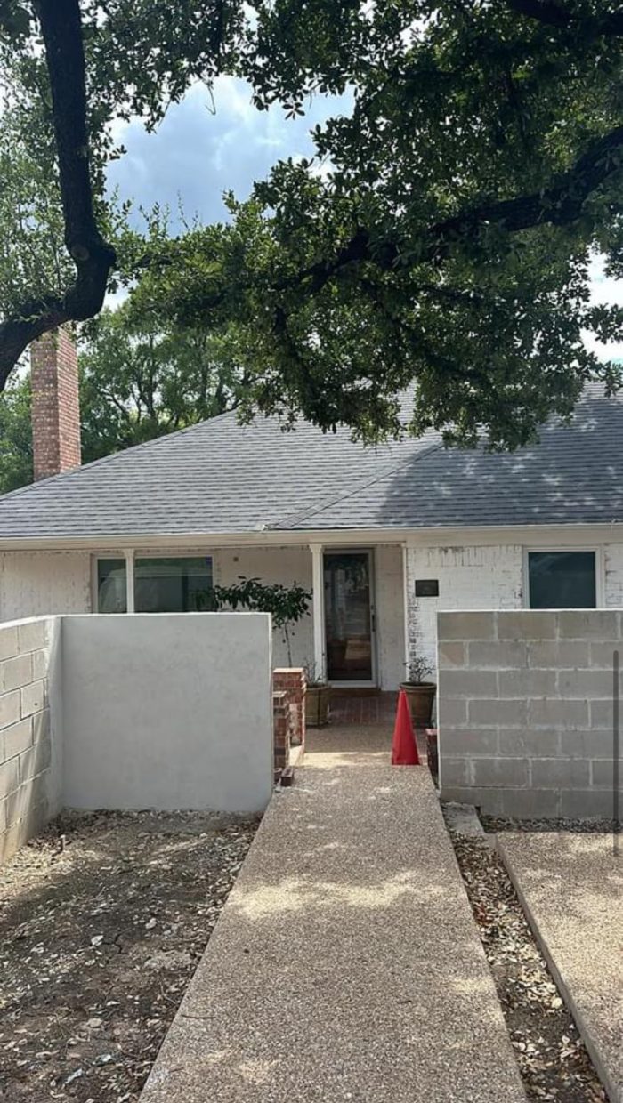

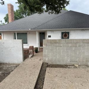

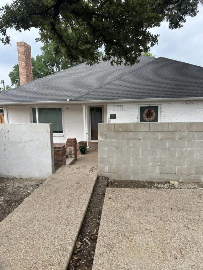

Hello! I have a 4’ tall, 110’ long cinder block landscape wall that I want to plaster.
I thought I hired the right mason to lay the wall after the concrete footing went in but it’s not plumbed or flush.
I’ve done so much research on how to address this so ended up buying a mini grinder and diamond disk that does a wonderful job at taking down the high points.
I’ve managed to get three masons to give me a mockup and bids but they want to charge $7,500-$9,500, with two of the mockups showing block mortar joints when wet. That will not work for me.
What steps does it require (in order please) to get this done appropriately? I’m going to attempt myself.

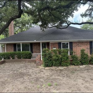

I do not want to use paint and it needs to be very white as I am lime-washing my home myself too. That costs a drill mixer bit and two $9/50lb bags of hydrated lime. They wanted to charge me $$$$ for that too and I’ve been taken advantage of so much in this year that I’ve owned the home that I’m going to take care of these projects myself!

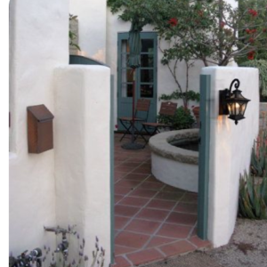

The pic is how I want the plaster to look – matte finish.
