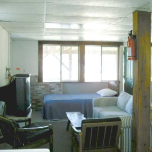

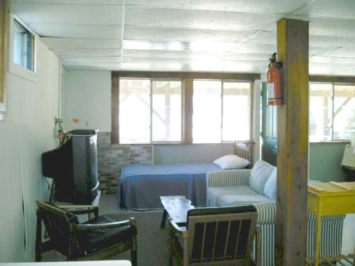

Here’s the room now:

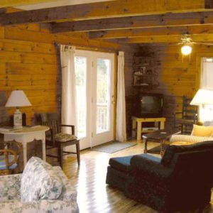

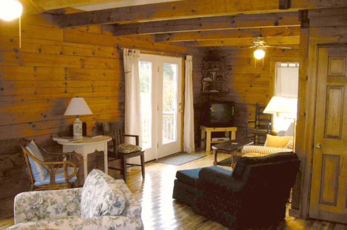

Here’s the living room upstairs, which has a new floor and new french doors:
(edit to add:  saving this as a smaller file did funky things with the color.  It’s all a nice aged pine color, not orange and brown the way it looks here.)
