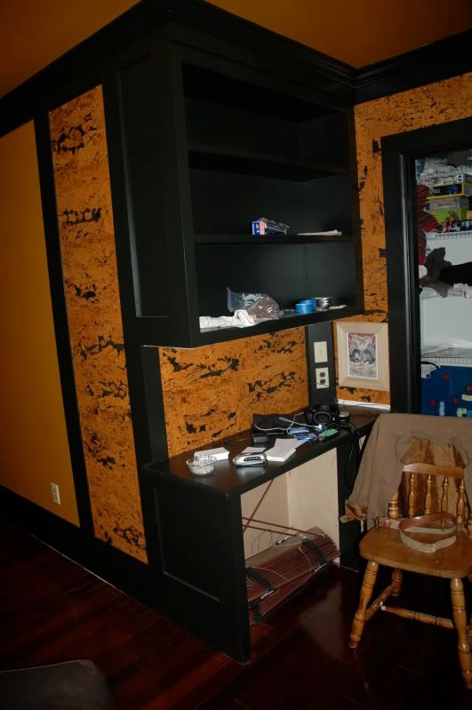

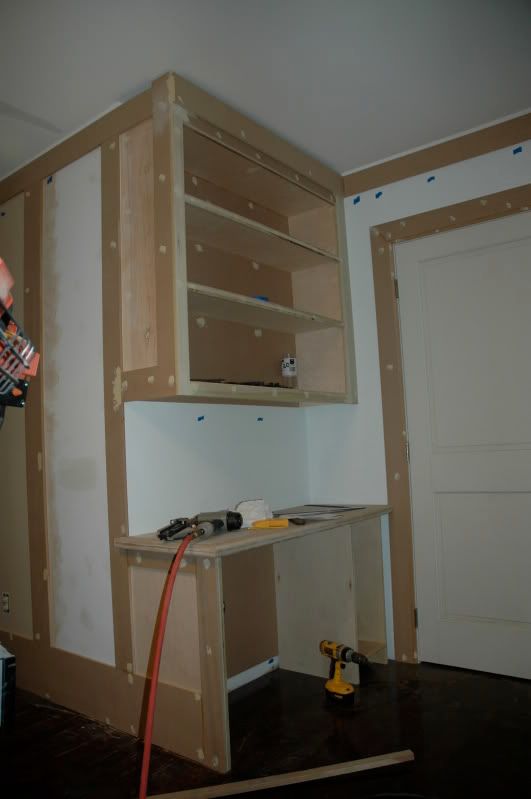

ABOVE: His built-in desk and over-desk shelves. The door is to his closet, that'll be replaced with a curtain. The bed it to the left.
ABOVE: The inside of his almost-finished bed. This was before the shelving was added. The pumkpin and black is cork.
ABOVE: Almost-finished desk area. Kneehole has since been painted black, closet curtain put up, switch plates painted, etc.

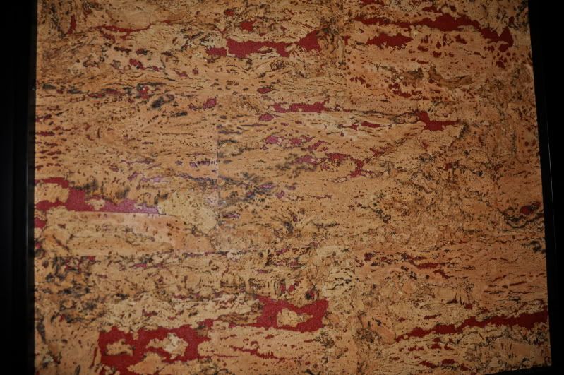

ABOVE: Here's a closeup of one section. This is one of those "95%" rooms...still 5% to go to completion. One of the things I'd like to do is give the cork a very light coating of paste wax to even out the sheen from one sheet to the next. It looks even to the naked eye, but the camera's flash accentuates variations in the wall.
ABOVE: In the corners I originally thought I might use a corner board of sorts. No need, I just butted the edge of one sheet to the face of the other.
ABOVE: With the wainscot, the larger windows, and the bookcases, there's not as much cork in this room per wall as there is in my son's room. I think I had a little under 200 sqft of cork in this room.
ABOVE: They had the 1/8" thick cork on clearance, as they are transitioning to the 1/4" thick sheets. Good deal for me, they had just enough 1/8" for me to use it in the backs of the bookcases. Less than $1 per sqft for the 1/8" versus the $2.10 per sqft for the 1/4" sheets. The center unit is about 12" deep with fixed shelves, the flanking units 16" deep with adjustable shelves. I'd like to put glass doors on the flanking units...some day. Overall this bookcase wall is 10' tall and about 14' wide.

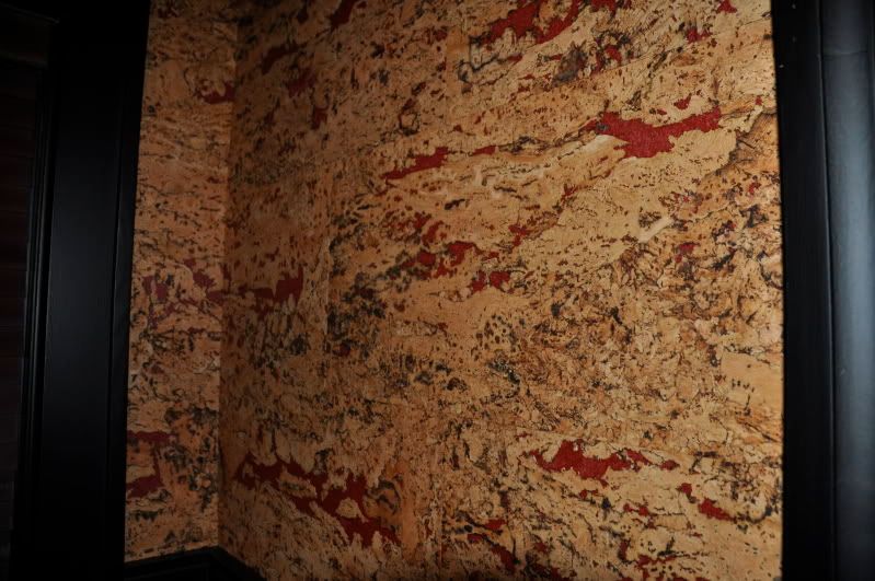

Very, very cool. I really like the look of this cherry cork. Reminds me of some Japanese woodblock prints, or maybe what Whistler would have done with his Peacock room if he had used this.You've got a fine eye for design. You study that at all or pick it up on the fly?Thanks for sharing.'Man who say it cannot be done should not interrupt man doing it' ~ Chinese proverb

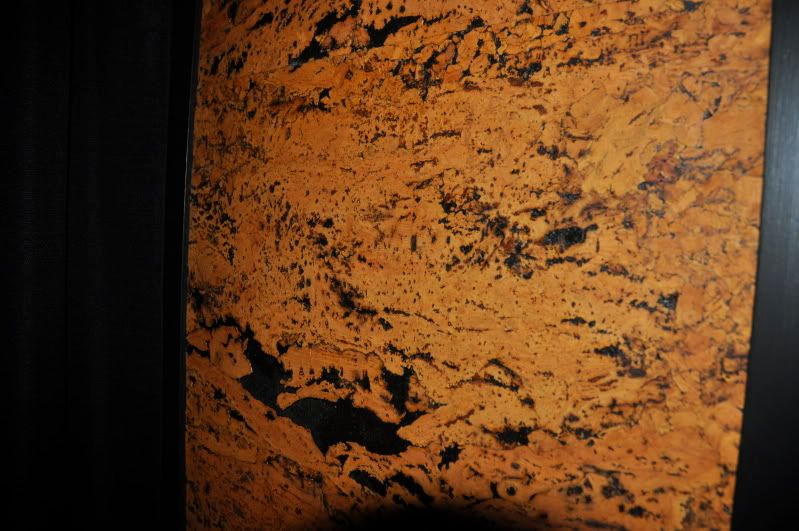

And here are a few more of the pumpkin.
Thinking about this, when I ordered the pumpkin, they had all I needed in stock. So I think my pumpkin order was all from the same lot or the same batch.
When I ordered the cherry, they were low and had it on backorder. So I think my cherry order was from more than one lot/batch, which was why it's less uniform in size and appearance.
ABOVE: Not much to say here.
ABOVE: The "wall" on the right is the partition that makes up the foot of the bed. Thus the three storage cubbies that fit under the inside-the-bed bookcases at the foot of the bed.
ABOVE: Close-up #1
ABOVE: Close-up #2
Overall, I think the seams are much less noticeable in the pumpkin than in the cherry. Still, I like them both quite a bit.
