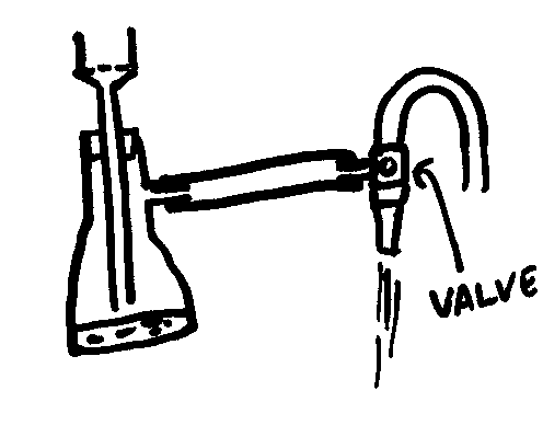

      2. HeavyDuty | Oct 04, 2003 04:18am | #13
        Dave has it right on, see post 11.
        Here is the set up in the lab. The valve is activated by pushing a spring loaded button. Run the water first before you open the valve. They always use a trap in the lab because you'll never know what kind of nasty stuff they use as solvent. In your case you can omit the trap. No plumbing, no electrical, no mess, looks presentable.

    1. DaveRicheson | Oct 03, 2003 12:58pm | #10
      You can also pull a vacum by venturi with  water at you kitchen sink faucet. Don't know if is fast enough for what you are doing, but any lab supply source will have the fitting that attaches to your faucet. No trap needed, no electric, and the fitting stores in a drawer with the vacum hose when not in use. They use to use larger versions of these to empty water bed mattresses.
