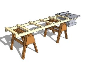

      Sphere | May 31, 2009 02:50pm | #2
      Speaking of cutting tables....
      I ripped an 8' 2x4 in half and then another, I cross cut the other 2 2x2 into about 32" and with one screw from UNDER the long rails into each short one, I have a laddder with 6 "rungs".
      Being as there is only one screw one each end of the short 2x2's , it can collapse like a parallogram for stowage and unfold for use. It also can be partially unfolded for narrower cutting.
      As the short 2x2's get kerfed up they can be swapped out real easy.Spheramid Enterprises Architectural Woodworks
      1. FastEddie | Jun 01, 2009 02:05am | #16
        I like that, especially the folding part.  And if you screw from the bottom up, that reduces the chance of hitting the screw with the blade."Put your creed in your deed."   Emerson
          Sphere | Jun 01, 2009 02:58am | #17
          Yep, I keep an eye on the saw depth, and never have hit a screw yet. Predrill the long rails so it has some slop, other wise the folding gets to binding. I'd guess a few washers wouldn't hurt, but I haven't used any.Spheramid Enterprises Architectural Woodworks

      2. jimAKAblue | Jun 06, 2009 03:44pm | #25
        Clever idea.

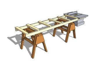

        Dreamcatcher | Jun 06, 2009 04:36pm | #26
        Before I had a tablesaw stand for my portable, I used a set up similar to that:
        Since the table of my tablesaw was exactly 1-1/2" thick, I used full 2x4's and the width between the "rungs" were the same dimension as the base of my table saw. The first rung was attached the depth of the tablesaw table away from the end and acted as a stop as I slid my tablesaw onto the rails. The whole setup could be unfolded, screwed to sawhorses, and table saw slid on ready to go in about 1 min. and acted as tablesaw, cross cut table, and workbench.
        I've been meaning to send a drawing and description in to FHB to put in the Tips section.... what do they give if they use your idea? Anyways, this setup worked well for me for years using an old $100 Craftsman tablesaw. I never took a photo of it because I always intended getting a new saw and building a new version for the new saw out of mahogany or something fancy. Instead I got the Bosch 4000 with gravity rise stand and side/rear extensions. Sometimes I wish I had the old setup again.
        DC
