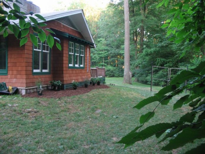

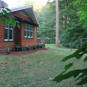

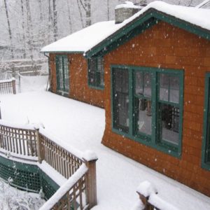

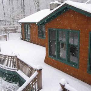

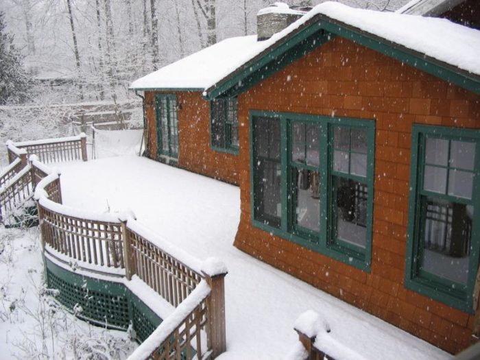

I did this with the Hitachi and SS nails, though not the Mazes you refer to. They have the best reputation. My splitting problems were limited to overdriving when trying to bend the shingle for the flare. So far, so good, but I am by no means a shingling expert.
