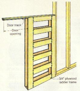

    The following is taken from JLC’s “TOOLS OF THE TRADE”, volume 1, Issue 1 from the Summer of 1993:
    I've found the biscuit-joiner handy for making frames on site for all pocket doors in 2x4 walls.  I rip up a good, flat piece of 3/4-inch plywood into 6-inch strips and build two ladder-type frames, securing the joints with biscuits.  These two ladders are then joined by top and bottom “plates” also ripped from plywood. The top plate extends across the door opening to make a continuous runner for the door track.  The frame is quite rigid, but allows easy access for installing the tracks and door.  The frame also provides a nailer for wallboard and trim.  You can build it on site in about an hour.  (SEE ATTACHED PHOTO).
