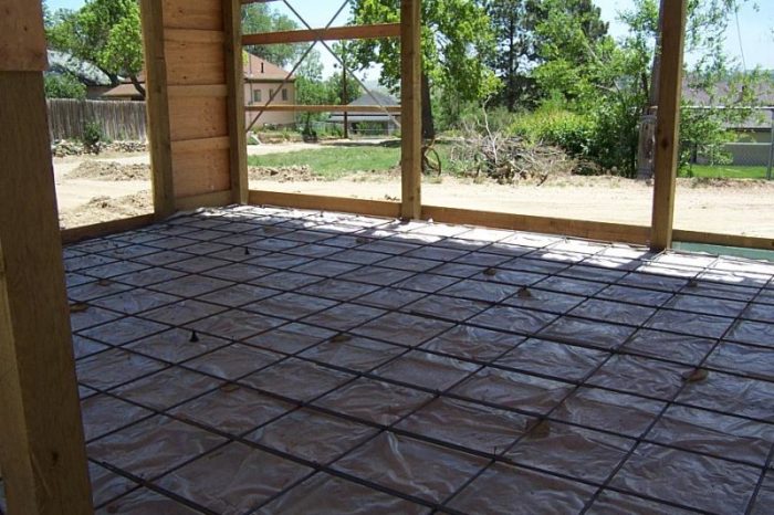

        Not sure if I made myself clear. I'm thinking direct bury 6x6 CCA right next to the existing slab, not actually pouring under the slab.I used a skid-steer mounted phd to drill the holes.Attached is a pic of my slab prep.

          Ohhhhhhhhhhhh.....I see....I was going to cut out the corners and middle of edge of the slab, dig holes, put post in holes with concrete to have the post built into the walls......hmmmmmm, so you have exposed posts with the walls inside them......I'd like to see how you framed your walls and roof system......If you have pics, please post.......
          1. husbandman | Aug 17, 2008 01:44am | #11
            I've done it two ways.My shop has horizontal 2x on the outside of the posts, 1 1/2" foam cut to fit, sheetrock screwed to same horizontals. I know that not much of an effective r value, but I only keep it from freezing and it's rarely very cold here.I've also placed the horizontals in between the posts and flat (horizontal) instead of the vertical way like my shop is. Finish out like any post wall section.
