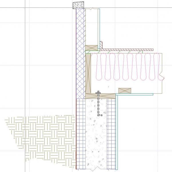

What’s less, EIFS stucco or phony stone?
Build with ICF foundation, using a block with 2.5″ foam  walls.  Frame to concrete core line, sheathe with 1/2″ ply or OSB, build out with 2″ EPS foam, fair joint of foam over ICF, use STO or Dryvit of type that can go below grade.
Cap with precast stone trim sill.  Siding above begun over flashing, which lips onto stone sill.
Pic attached.

  1. DaveRicheson | May 06, 2009 01:19pm | #1
    Is there such a beast?
    All of them I have looked at call for termination above grade. Most call for edge wrapping the bottom of the foam board with mesh tape and maintaining an open weep area beneath the board,
    Got a link to anything that go below grade?
      Gene_Davis | May 06, 2009 02:00pm | #2
      Go here and look at detail 0.0.06.
      "A stripe is just as real as a dadgummed flower."
      Gene Davis        1920-1985
      1. DaveRicheson | May 06, 2009 05:09pm | #5
        Thanks Gene.
        That base detail has changed since I got the Dryvit literature a few years ago. That inspection strip is new. The old detail kept the foam away from ground contact and that space was the inspection strip.
        What ICF are you using? Is it borate treated to keep the creepy/crawlies out of it?
        Look at DowGuard for a foam that is rated for earth contact. It is not a stock item at my supplier, so I have to buy it in full units,
