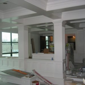

        3. DougU | Aug 05, 2003 03:56am | #11
          Manroot
          I'm with you, theres a place for MDF in high end homes. I have used it for a lot of applications.
          The picture here has a lot of it! The milled mouldings are mainly popular, but the columns are MDF as is the panels, stiles, rails, base and most of the coffered ceiling.
          1. KGambit | Aug 05, 2003 04:05am | #12

             All I have to say is "Holy Crap, That is some beautiful millwork"I don't understand! I cut it twice and it's still too short!
          2. DougU | Aug 05, 2003 04:14am | #13
            Manroot
            Yea, love the painted wood. I like the way you used yours in your house, I have some vintage caseing that I believe would be a match for the stuff you have around your stained glass window. Dont know if you got the idea from some antique millwork. I have always like painted wood more than natural, with the exception of tiger maple wood.
