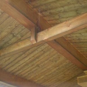

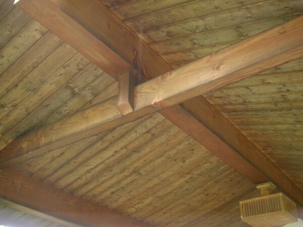

I would be inclined to double the ties up for looks. A single 2x spanning 16' is going to look pretty lonely.
or make it something decorative.
forgot
Without a center post, all the beam is doing is preventing the rafters from spreading so it can be fairly small--it's acting as a rafter tie, not a beam. You would need another rafter tie between that one and the house to meet code. Single 2x6's would probably be big enough, but a 2x8 would look better.
