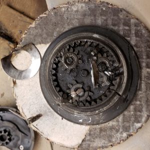

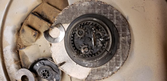

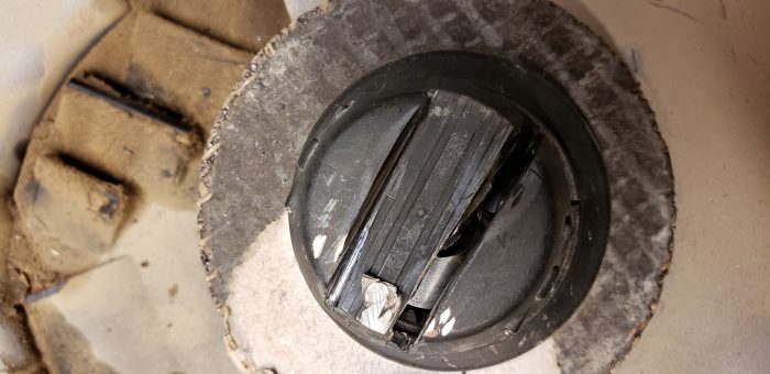

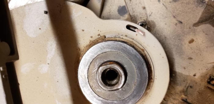

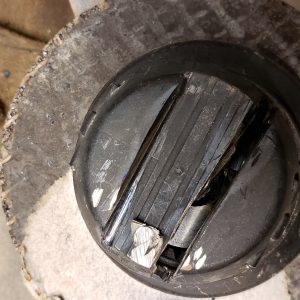

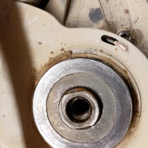

  3. user-7028178 | Jul 13, 2019 06:14pm | #12
    I have the 423Mag. Same problem. Nut spun but wouldn't come off (after using a abrasive wheel blade in concrete). I slid the lever out, peeled off the ribbon spring. Then I took my grinder and ran it parallel to the track the lever is in. I was able to pry off the lever. A bit more.grinding and I was able to split the top piece and everything came out. Then I was able to take the pliers to the nut and take it off. 5 min work max. See pics
