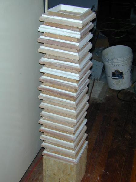

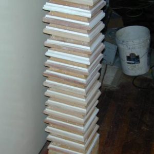

    Attached is a pic that I had posted a couple of weeks ago. It's what I'm doing for the fence/railing/wall around the deck that will surround my hot tub.
    The posts are 6X6. The fence boards (pickets?) are milled from 1X6. The crown is milled from 1X4, and the trim at the sides is 1X4. The topper is 2X8. I have not yet decided what to do with the tops of each post. We might decide to put low voltage lights there, or maybe I'll just mill up some sort of cap.
    All of my material was PT pine -- a choice which I would not recommend. The stuff just moves way too much. My fence boards are milled with a molding which matches the 50's-style pine paneling inside the house. It is also tongue and groove. I did all of the milling in an air-conditioned shop -- hoping to reduce the moisture content of the wood to the lowest possible point. I then took it directly from the shop to the fence, nailing it within a few minutes. (Again, hoping to reduce the effects of wood movement.)
    The tongues are 1/2 inch wide, in the hope that even with shrinkage, there will be no visable gaps.
    Since this photo was taken, I have used a translucent stain, and have done much of the work on the deck. Maybe I'll be able to post another pic soon. So far, the wood movement issue has not reared its ugly head.
    Vast projects should not be founded on half vast ideas.

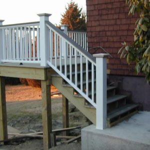

  3. YesMaam27577 | Jul 25, 2003 10:28pm | #7
    OK, while I was posting that last one, the babysitter called, and I had a few minutes to get the newer picture. Please forgive the construction mess -- but I'm sure you understand.

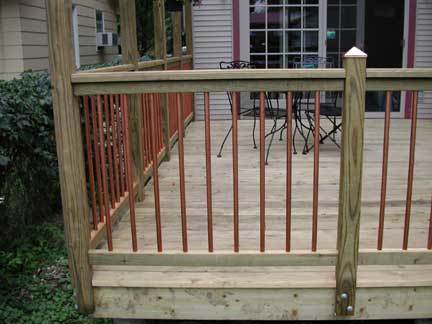

  5. Shoeman | Jul 27, 2003 01:57am | #13
    Don't know if it will work in your situation, but, I have used copper pipe for the spindles a couple times lately and have gotten nothing but compliments.  I used Pressure treated top and bottom rails, with 7/8 " holes drilled in them that accept 3/4" copper pipe very well - nice and tight.  I drill a 1/4" hole all the way through the bottom rail to allow any water to drain.
     I know the Trex is not as ridgid as the treated, but, something like this might work if you slip a little piece of pvc under the bottom rail at mid span.

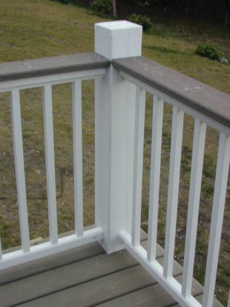

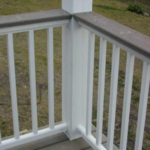

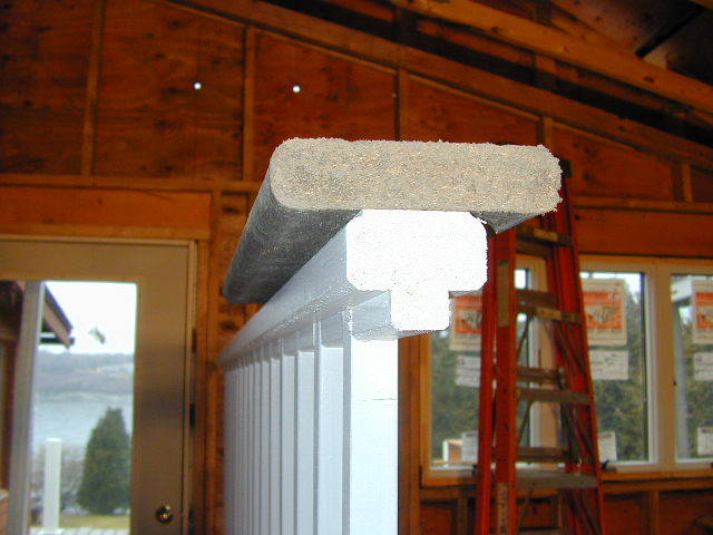

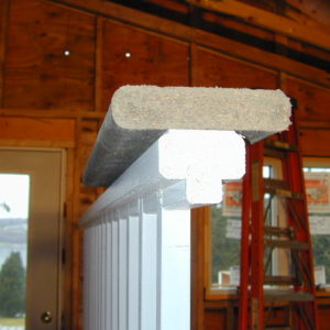

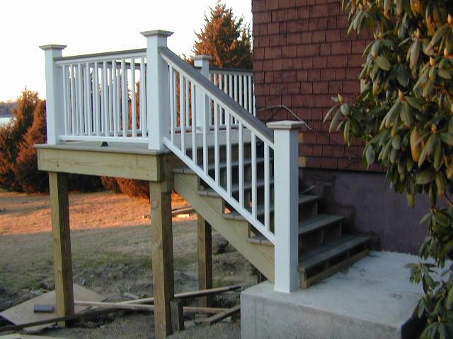

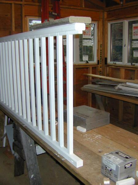

          we do a lot of trex decks.. here's one of our favorite rail treatments..
          6x6 PT posts... merante' 1x1 balusters ( from 5/4 x 4 ), reante' shoerail and  RC subrail..
          trex railcap..Mike Smith   Rhode Island : Design / Build / Repair / Restore
          1. xMikeSmith | Jul 29, 2003 06:40am | #19
            we also made our own postcaps.. but next time i'd buy the ready made onesMike Smith   Rhode Island : Design / Build / Repair / Restore

            Mike...Thanks for the pics, your railings look excellent. There have been a couple of good suggestions in this thread. Now I've got to try to decide what to go with! I don't understand! I cut it twice and it's still too short!
          3. MojoMan | Aug 02, 2003 03:53am | #23
            Mike:
            What do you use to get that nice white finish on the PT lumber? Thanks!
            Al Mollitor, Sharon MA
          4. xMikeSmith | Aug 02, 2003 04:06am | #24
            al, i'm pretty sure we use BM Fresh Start primer, and BM 100% acrylic house trimMike Smith   Rhode Island : Design / Build / Repair / Restore
    2. KGambit | Aug 01, 2003 08:48pm | #21
      Shoe
       I think I might try the copper balusters. How do you attach them to the sub rails? You drill a 7/8's hole through the subrails and push the pipe through, but you can't just use friction to hold subrails in place can you? Do you screw through the pipe into the subrail? Let me know what method you used to secure balusters...thanks!I don't understand! I cut it twice and it's still too short!
      1. Shoeman | Aug 02, 2003 01:31am | #22
        Manroot,
        I use a 2x6 ripped in half for the subrails.  This gives me top and bottom subrail that is   2 3/4 x 1 1/2.  I also run a roundover bit on them for looks.  I drill the 7/8 holes about 1 1/4" deep on the 1 1/2" side.  Then I slip a couple 3" high blocks on the decking to hold the bottom subrail up to the height I like to install it at.  Screw the bottom subrail to the posts, install copper spindles in holes, work the top subrail on, scew top subrail to posts, then gorilla glue and finish nail handrail to top subrail.
        Oh yeah, forgot to mention, on the bottom subrail, I drill a 1/4" hole all the way through the wood in the center of each hole to allow for drainage of any water that might get in around the pipe.
        Think I might be able to get you some pictures tomorrow.
        You should be able to get four spindles out of each 10' section of copper pipe.  I use my old Craftsman power miter saw set up with an old cabide tipped blade that I don't care about  - set a stop and cut spindles in a hurry.  The ends are a bit rough and the 7/8 hole is tight - so I clamp a belt sander upside down and give the ends of the pipes a quick de-burring on there.
        Also -  laquer thinner on a rag gets rid of the print on the pipes quite easily - lots of thinner - soak the rag.
        Another nice thing about the copper spindles is that you don't have to stain them every year or two like you do wood - saves a ton of time - and if you happen to get stain on them when you stain the rails - Laquer thinner on a rag and your done.

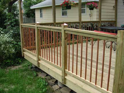

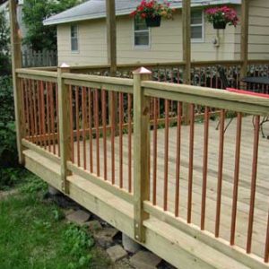

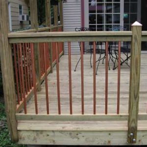

          1. Shoeman | Aug 05, 2003 05:14pm | #26
            Homeowner just emailed me acouple pics for ya.  Probably be seeing your pics soon though.
          2. KGambit | Aug 06, 2003 05:41pm | #27
            Shoeman,
             Those railngs look nice. I don't know how soon I will be posting pics. The weather here in the North East is not cooperating with me! But if I ever get it finished I will post a few for ya! Thanks!I don't understand! I cut it twice and it's still too short!
