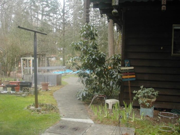

    Of course there is.  With the planter strip you get shoulder room and you wont bash the wheelbarrow into the side of the garage sometimes.
    Also, if you plant BIG rhody's in the planting strip, you can score points off and feel justified in yelling at hubby when he clips off higher branches that are over the walk (and had been slapping him in the face with wet leaves as he walks by) at the wrong time of the year (dont ask how I know this <G>)

        Without the planter strip you cannot hang bells and such from the garage wall for the grandkids to ring, otherwise you bash your head in.
        For rhodies, if you are 5'-2", you trim the branches only to clear your head, the higher ones are pretty.  If he is 6-1",.he can duck.

        1. joody | Mar 28, 2009 05:14am | #13
          Are those Redwood trees in the background? What part of the country are you in, Junkhound?
          1. junkhound | Mar 28, 2009 04:31pm | #17
            20 miles SE of Seattle.
            Most of what you see in the pix are Doug Fir, biggest about 80 years old.
            Did plant about 40 giant sequoia in the back 30 years ago, but none to be seen in the pix. The 'bare' tree behind the trampoline is a big leaf maple.
