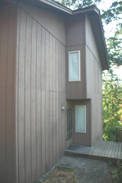

It didn't occur to me that I could post photos until I saw the photo of the scaffolding! So, to help explain the project, here are two photos of the west wall(s) of my house. As you can almost see from image 8120, the stairs going down to the lower level make it impractical to grow something on a trellis on that part of the wall.Not visible to the west (right) is the drop off, and then hill, currently covered with blackberries. Putting a couple of large trees on that hill might help, but it will take several years to get to a height that will make any real difference.I understand the concept of extending the jamb. It gets a little close in that corner, though (image 8121). It might work if I don't change the thickness of the small bit of wall with the windows.
More food. The proximity of the windows to the adjoing wall will affect how much you can 'pack out the wall'. I looks to be maybe just a couple of inches. The small north facing walls don't need to be touched in the project.
Sounds like the hill is too far away for trees to be affective. You can still put a trellis in, just don't grow anything on it. Got to think outside the box.
In the grand scheme, though, you really aren't in a cooling climate (I have a house in HR just east of you), and the need for the added benefit is only a handful of days a year (maybe this year is an exception?). Try to keep it simple and inexpensive. Maybe some other architectural elements that will effectively shade it. Be glad that wall isn't a window wall with that 'fabulous sunset view' ... you'd be begging for what you have now!
That was my thought, too. The north wall is too small, and only the 2nd floor part of it is in the living room. The first floor wall is behind a closed door to the basement. The orientation isn't truly north, but more northwest. Thus, it does get some late afternoon sun. We have a roll-up shade inside on the 2nd floor window made of "warm windows" material that does a pretty good job of insulating.We'll give that trellis without plants some thought. It might be the way to go. We'd have to leave the bottom of it 6 or 7 feet above the deck and outdoor stairs, but that's not where the worst of the sun is and, again, that part is the enclosed stairwell to the basement.Yes. Inexpensive is the only way to go. Otherwise the payback would be too long.As I hinted at, above, the west wall isn't really west but more south west. There are trees shading the sunset, but not the mid-afternoon sun.
