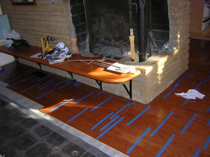

        I bought Anderson/Bruce 3.5" x 3/4 Oak "Gunstock".  My suggestion, plan on a LOT of time if you install it your self.  I am still fighting the product.  If you hire it out plan on spending quite a bit more to have a pro lay it if you can find one who will touch it.
        My first order that I bought almost two years ago stacked in boxes in my house for almost a year because of a kitchen remodel when I went to use it was warped in every direction and varied in width as much as a 1/8" or more between boards.  I raised hell with Lowes and got it replaced, they admitted that A/B had a problem with milling green wood and was improperly dried.
         They replaced the wood this spring and I am continuing to fight this crxp .  My new batch they told me was not supposed to vary by more than 1-2 mm in width, well guess what that's a bunch crxp. I used a digital micrometer and sorted into piles, I also use a simple folding rule with the brass inset slider that works well for gaging width as well.  With the old stock I had 9 sorted piles, with the new I am down to only four so far. I have only went through about 1/4 of my pile of flooring.
        Another caveat, they tell you they will only take back wood that is in the box but yet they tell you you must open the boxes and let the wood acclimate to the room for at least (I think) a month or more before you lay it.  You need to stack it, I used the shorts to go crosswise across the pile.  Save your boxes, you may need them.
        I have to sort every piece carefully looking for any damage, then by width.  It took me about 4 hours to lay out and nail down three rows 18' long (working by my self) , even then I had to use colored putty, the soft kind that you can mix together to get the desired color, find this at good woodworking stores, (they do mention this in their enclosed booklet) to fill a few cracks between the boards.  I should of been able to nail down half the remaining floor in that time.
         BTW you will want to make sure you keep the humidity at 30-50% otherwise it will shrink after its laid. I am using the Bostich big flooring stapler as well.
        It does look pretty good laid out but a major pita.
        If I wanted solid hardwood floor again I would definitely go with unfinished and then fill the cracks with the proper putty and call in a pro to finish.  Much, Much faster.

            I haven't had any experience with any other manf.  I am a woodworker, diy'er, owner builder but laid a fair amount of pergo type click lock and glue down flooring and tile work.  Never expected/experienced this type of mess before.
            One suggestion, if you can get the flooring person you are dealing with to put it in writing (which I doubt they will do) that the flooring width will not vary between boards and that you can get your money back if it does AFTER it is acclimated to the local environment for a month or two then go for it.
             I did check the wood at the store and the half dozen boxes (out of 35) I opened up did seem pretty much to be very close to the same size.  Two months later when I am ready to use it, it isn't.  I know that wood moves and depending on what the grain run is it will shrink and swell differently and my lack of humidity up here in the far frozen north is a problem.
             In retrospect I am a little unfair towards the manf. as there is a chance that the width problem is more of my environment and not the manf. variance between mills that produced the boards.  It is curious though that it seems to be more of a variance between boxes. I took the wood out of each box and stacked it in a 3x8 pile and each box makes about a 3" stack and I noticed that most of the boards in each stack are more or less close.  Whereas some of the boards further down may be +- from the top boards.  Like I was saying I sorted what I am using at any one time (not much space to stack stuff) and "only" have four different piles so far.
            Width variance will really screw up a floor, espically if you are working fairly fast and the first board you grab to start your run does not match the next board you have automatically a built in gap.  The next row will look even worse. Don't do like I did and try to plane down the difference as the edge has a slight bevel and if you plane it off you will have a sharp edge to deal with.  You can however plane the ends to get a square butt joint which is sometimes required.  Make double darn sure you start you row out perfectly stright. I didn't and now almost every board has to be beveled on the end slightly.
            BTW don't ask how I know but a Fine multi-master tool can make short work of taking up a board (s) that are stapled down.  Hell on the blades but works quickly and you can salvage the entire board.  You haven't lived until you are just pounding away and have the hose catch the stapler just right or bumped something and drive a staple through the top of  a board.
            If you prep your subfloor properly and follow directions you can do it.  Plan on spending a lot of time doing it though.  In my case I have more time than money so I consider it part of my daily workout regimen.
            Good luck and I hope it works well for your installation.
