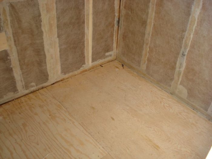

I made up a wand from 1 1/2" PVC, but without the restrictor plate, the cells would back up in the hose due to the restriction. I was also using a short 25' hose. I suspect using a longer hose would have helped, but the folks at Lowe's didn't know where that was either.
I would up cutting bigger holes in the mesh than I would have liked, and just crammed the 2 1/2" hose in and let it fly. I got a fairly good density in the stud cavities, and may have even over-filled a few. I may have to pull a few handfulls of cells back out and try to redistrubute a bit if it appears that the wallboard will be inpeded.
Here's a few shots after I blew the walls.

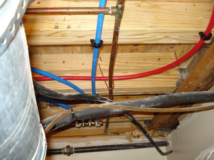

Years of leaking tubs, sinks and toilets had taken its toll on some of the floor joists. One of the shots shows the new joists as well as the PEX manifold and some of the PEX home runs.

Sounds like the same fine Lowes employees I ran into on my first visit. LOL, did you think you had a cellulose firehose when you fired that sucker up? IIRC, Steve at Regal said you didn't need the restrictor plate if you were blowing the Regal wall, but as you found out, a 2" wand would have been less prone to clog.
But looks like you got 'er done. Should be a nice, tight wall. I noticed on some of mine that the rooms seemed a lot quieter after the cell went in. less outside noise and less echo when talking or using tools in the room.
