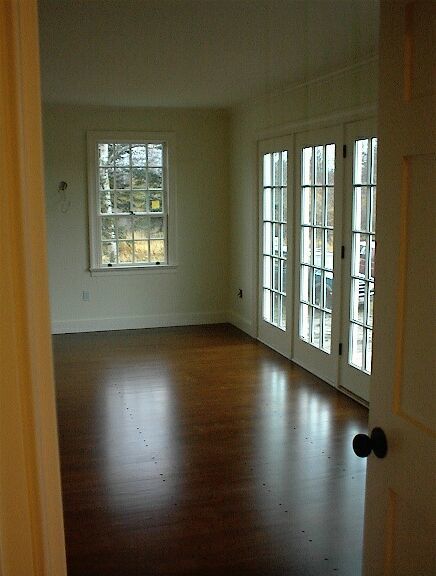

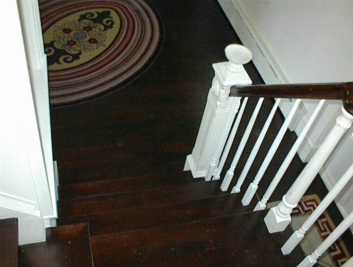

Here's a few shots to tease them with
What Piff said...I kinda get tired of writing the same thing over and over. Use the search feature first.
Just wait till you try and sand the floor. Have fun...lol. Count on getting on your hands and knees with a hand sander after your done using a drum sander.
If I were to do it again I'd try and do as little sanding as possible. My floors came beautifully milled right from the mill. If only I could work in my socks and not get them dirty I might have gotten away with a light screening just to get the mill haze off.
I did just about my entire house with Eastern white pine wide plank. From 6" to 22" wide.

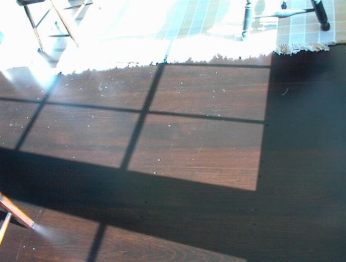

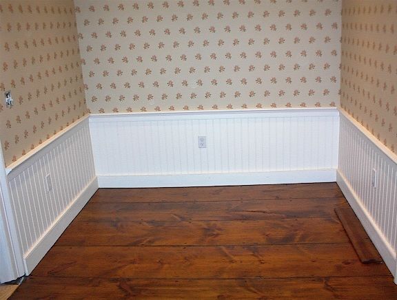

You finish the pine with oil?
No, I didn't use oil as my finish. I wanted a harder finish so I went ahead and applied a first coat of high gloss poly then two top coats of a satin poly. Its a total matte finish and it really does look great. Doesn't have a plastic looking finish what so ever. In my living room I did use the oil and I hated it. Hate how it wears and its pretty difficult to apply to boot but thats not the reason I didn't keep going with it. I just didn't like how it wears under major traffic. I must have put on more than a half dozen coats too.
Here's a few not so great pics. The bedroom floor is still wet with poly.
