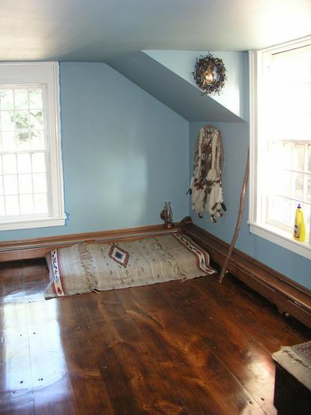

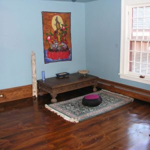

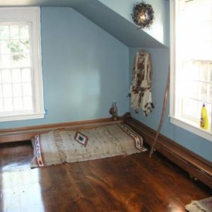

    I did my pine floors this past year and my floors are over 326 years old.
    If they're not really bad don't use a drum sander. Good chance you'll leave chatter marks. Try just screening them. If you dont have miles of flooring to do use a ROS with screening on that. Sheetrock sanding screens. If that doesn't do it then rent a floor buffer and get the right pad and round screen from a rental company. From the sound of it thats all you should need.
    I used three coats of a matte' poly in most of my house and it really looks very soft and natural. On the first room I did I used water lox but thats wayyyyy too much work for large areas and to be honest with you I really don't see all that much of a differance and poly is way more durable...thats just my opinion.

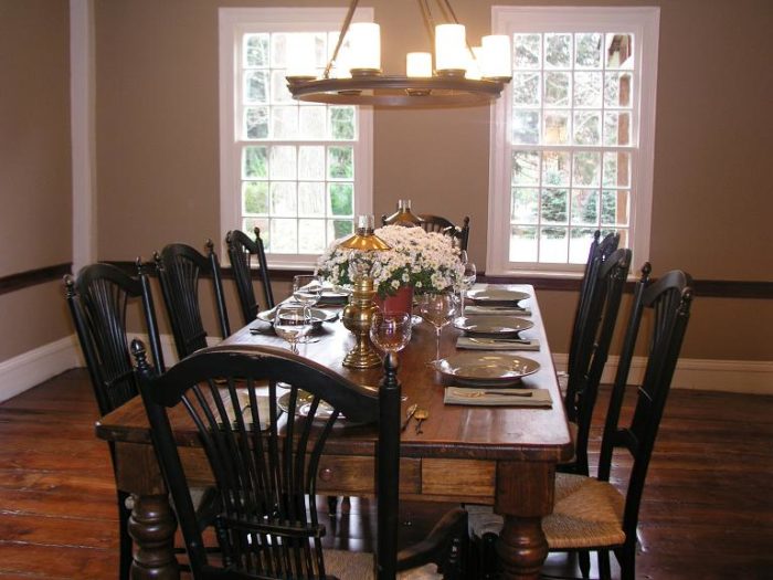

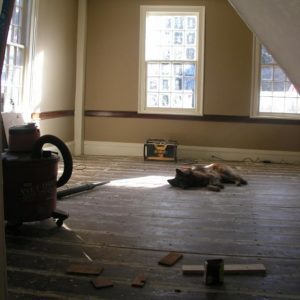

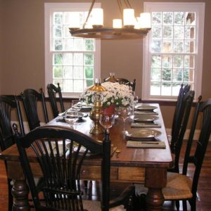

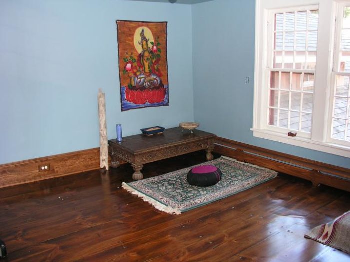

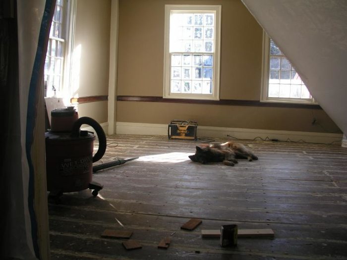

    PS...the floor with my dog Chakra in the middle of it is the same room as the room with the dining room table.
