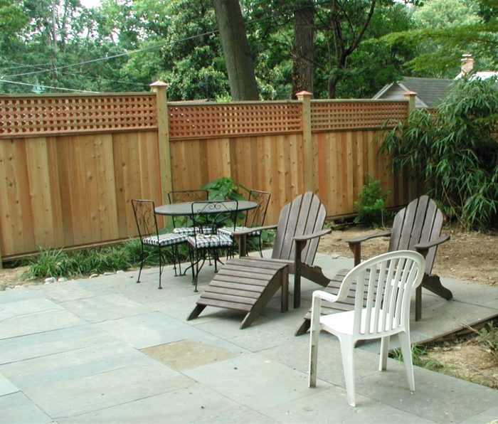

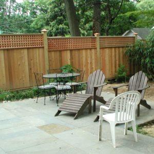

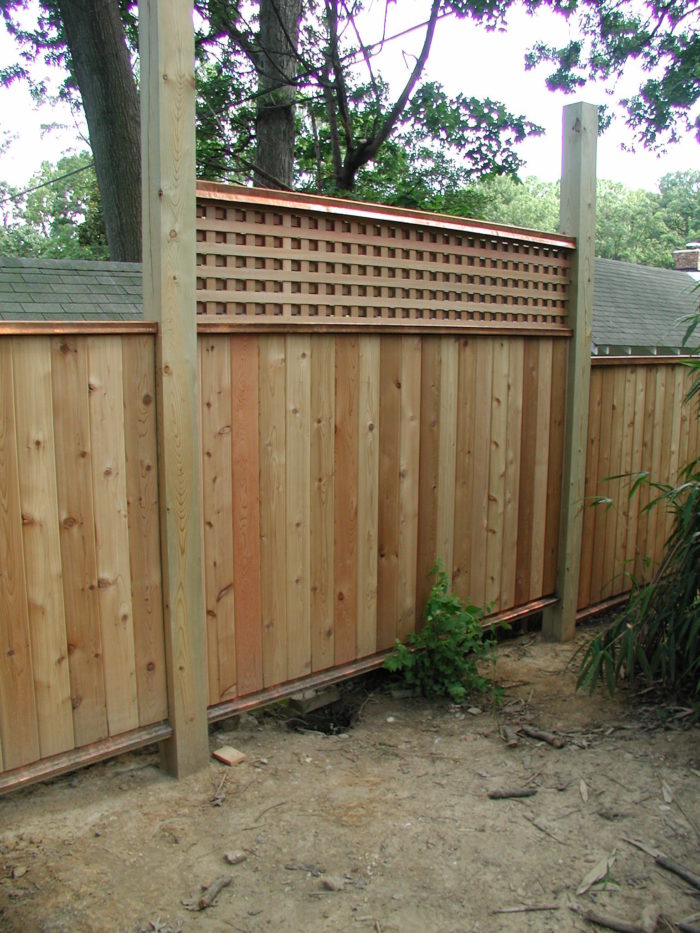

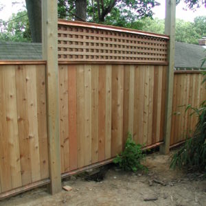

    alternative
    Here's some photos of a privacy fence we did a number of years ago that is P.T. and cedar. The horizontals are flashed with copper.
