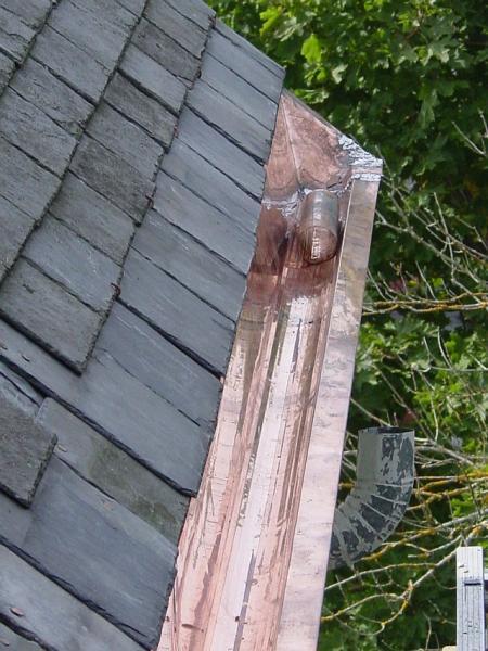

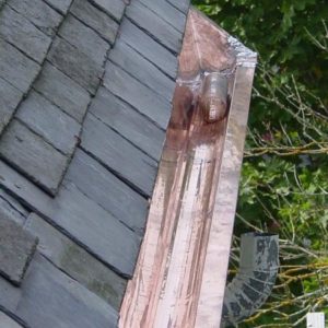

    If you really want them to last then lining them with 16 oz. copper is a great way to go.
    These were done across the Bay from you on Vinalhaven
