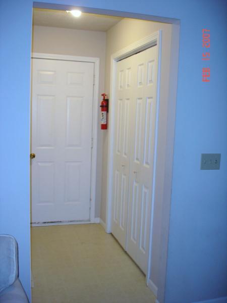

I have replaced this standard 6′ closet with a custom storage unit with a space for each member of the family:
The painted surfaces have a coat of primer and three top coats of Valspar Ultra Premium Kitchen and Bath Enamel.
I would like to further protect the surface of the shelf area above the drawers. This area will surely see school backpacks and such dragged across the surface.
The ideas I have so far is to add a couple clear coats of acrylic or even polyurethane.
Thanks for any tips!
