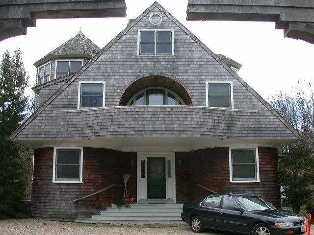

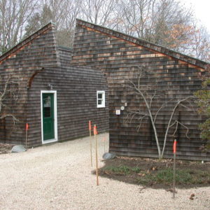

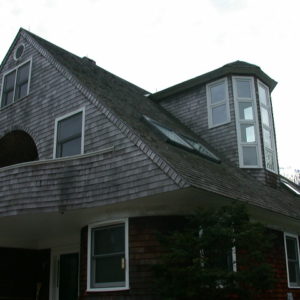

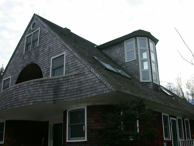

            this job will be strip & reroof.. access is between the two garages , which form a courtyard... 12' between the garages
            what kind of platform  would i be looking  for ?Mike Smith   Rhode Island : Design / Build / Repair / Restore

          8. fdampier5 | Jan 02, 2004 07:15am | #33
            Mike,
              I can't really see the grounds around the area but I suspect from what I can see you might be better off with a manlift for that, then a forklift..
                The reason is that the manlift could work in a smaller area then the forklift would.. get what's called a knuckle lift in order to be able to go up and over with out having to go back a long ways..  Also be aware that the machine will be heavy.. very heavy.. a forklift weighs around 20,000 pounds and it's on four tractor type tires. if the ground is soft it will tear up the lawn.. a manlift on the other hand is as heavy (or heavier) with smaller/wider tires that aren't  nearly so aggressive.  It's still a very good idea to lay down plywood to avoid tearing up the grass (or go when the ground is frozen rock hard or baked bone dry..)
              You might be able to do everything with a 40 footer but fifty would probably be better..  if you get a forklift you'll definatly need all of a 40 footer.  get one with at least a 10 foot work platform,   with a couple of guys I like to use a sixteen foot work platform since it goes so much faster you kind of need that space to keep out of each others way..  (and try to use one with end pockets..)  If you get a manlift make sure that you have at the very minimum a five foot basket.

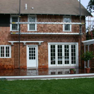

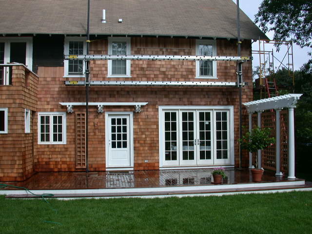

          4. xMikeSmith | Dec 29, 2003 06:24am | #16
            yeah.. they can be .. but they go down like an otis elevator.. and not much effort to get 'em back up again the next day..  so you can drop them and tip the pic on it's side so it's ready for the next day
             here's a 24' setup with 24' poles... a 20" pic for standing on and a 14" pic for a work / safety railMike Smith   Rhode Island : Design / Build / Repair / Restore
          5. Ronbaby | Dec 29, 2003 07:20am | #17
            its amazing how everything looks so much cleaner when you wet it down with a garden hose before you take a picture.

    Sphere | Dec 30, 2003 12:22am | #22
    Ok all ye nay sayers, and prophets of doom and despair. I have a safe solution...REMEMBER I AM USING THIS SHORT TERM>>>I am not going up on jacks for a living..I need to chink my logs and do some trim.
    I will nail 2x4's PT as CLEAR AS I CAN GET..with blocks 2' long in the middle, with a space for a 2x6 SPAR to be inserted at a RT angle, and have the spar tail protrude out the out board side where either a plank for a work table OR a removeable PIN will keep the spar in the slot. The spar will have an upward angle of a few degrees to help counter any deflection (picture the guys notching trees and putting in boards as they go up)..and that will carry the walk board (of aluminum persuasion) that I will buy cuz I can still use that with my ladder jacks too. So all I have to do is add spars going up and remove as I descend.  Tied to the roof just like pumps, and re-useable as a lumber rack in my shop when they are no longer needed.
    If that don't work, I am getting 2 ladder-vaters and tie the throttle cables together and beam my self up like a bundle of shingles<G>.
    1. jimblodgett | Jan 01, 2004 09:39pm | #23
      I've been using pump jacks on wooden poles since the early 70s and I like 'em just fine - not to say I didn't have to learn how to use them, though.
      Spent more than one lunch hour changing soiled pants from that sudden drop of 6 inches, when you use a hammer to overcome a stuck jack.  Took me a while to learn that when the jack sticks on the way down, pump it up a little and clean the burrs off the back of the post with a knife or chisel/screw driver.  Haven't had a problem going up, or down, with wooden poles in I don't know how many years.
      As for all you guys talking "increased productivity", why stop at allumipole?  Why not just go buy yourself a Lull?
      At about $150.00/jack (with tool rests and standoff brackets) buying a pair of pump jacks to get started, then adding through the years as need dictates, is still a great a great way for aspiring builders to go.  But I agree that there can be a learning curve to safe use and some people would be better off with some other system.
  7. 10man | Jan 02, 2004 01:12am | #28
    Sphere, I changed from the double 2"x4" method you described to using a 2"x4" and a 1"x4" with 3/4" plywood sandwitched between, all secured with exterior glue, long gal. staples, nails and a few screws where needed. I like it a lot better. Still, you gotta be extra careful on these things; it only take a heartbeat to change a life forever. Good luck.
