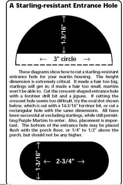

In my quest to build a bunch of purple martin houses for my Son’s fund-raiser, I’ve run into a problem. After doing some research we’re trying to come up with a 1 3/16″ forstner bit to make the holes with.
You can get a look at what I’m trying to do in the attached picture, or download it in PFD format at:
http://purplemartin.org/downloads/BestManage.pdf
Trouble is, I can’t find a 1 3/16″ forstner bit. Anybody have a source for one? I’ve searched the websites of tool crib/amazon, woodworker’s warehouse, and McFeely’s.
I tried one of those adjustable hole saw/circle cutter things with the “arm” that has a cutter on it. But it quickly plugs up with the rings it cuts out, and it tends to “grab” the wood pretty bad.
Any suggestions would be appreciated.

Maybe you can make a jig and use a straight cutting bit in a router.
Not a bad idea - I may try that if the forstner bit doesn't show up soon.
I'm not 100% sure on this though. I wanted to find some tasks the boys could do. I'd rather have them drill a hole in something clamped in a drill press than run a router.
But it's definitely worth thinking about.Change is certain, progress is not. [E.H. Car]
The boys would love running the router! All the noise and chips flying! More Power!!!!
After thinking about it a while, I wondered if a combination of the 2 tools could work.
Drill the initial holes with the forstner bit. Then clean it out with the router.
