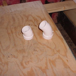

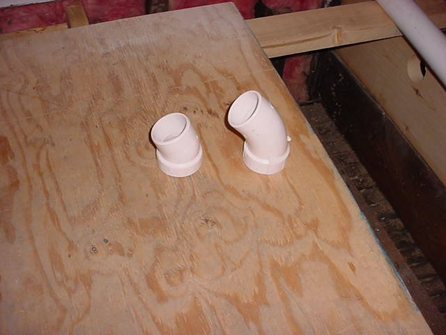

I may be in the proverbial spot of a rock and a hard place. Laying out a 2″ pvc drain system in a to be  enclosed floor. Rather tight surrounds involving already stationary points of a shower, stool and cast iron running from the neighboring kitchen with a vanity that is the only variable except it must be run alongside an 8″ joist space. Anyhow…
If I had an elbow halfway degrees between these two it would solve a lot of problems.
Do they make a special order holygrail like that?

    Your fitting on the left turns 22.5 degrees.  Fitting on right turns 45 degrees.
    Fittings are readily available (even at some big boxes) which turn 11.25 degrees.
    So 22.5 + 11.25 = 33.75 degrees.
    Your space is at a premium - the additional length may not be helpful.
    Absolutely legal if the assembly will fit in the space available.

    1. rez | Feb 25, 2009 03:55am | #19
      Thanks all. I managed to steal a degree or two turning the shower drain a tad and altered the lengths of some pipe lengths enough to find a fit.
