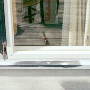

      1. ahneedhelp | May 27, 2003 05:28am | #5
        Dear Piffin -
        Boink me over the head for being clueless but I am trying to figure out what it is the photos are trying to show.....
        What's going on with the taped X ?
        Sorry I have to ask.
        1. Piffin | May 27, 2003 05:53am | #6
          The loss of visibility from losing the seal in the one casement sash. We were talking about seals and welded glass.
          The painters masking was how he alerted me which windows to study for bidding replacements - so I wouldn't miss anything..
