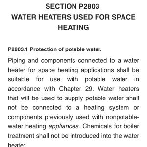

  5. wallyo | Feb 01, 2022 01:27pm | #73
    I know this is an argument from a bit ago. But been looking into various ways to set up a hydronic towel warmer (yes must be stainless steel construction) on to an existing water heater for domestic hot water
    We added mini splits in the house but at times the master bath can use a bit of a boost.
    So had two thoughts:
    A) just tap into the water heading to the jetted tub or shower. When they run the water first flows through the warmer.
    Probably just going to heat the towel
    B hot water circulation pump for master bath sink with water running through the warmer first. Can use a pump with a timer set it to come on in the Am in winter for a long period of time. In summer short periods.
    Then I came upon this discussion my thoughts was there anything in code that prevents it?
    According to the 2018 IRC which in our area covers homes of 1 or 2 residents and also covers most of the nation, No.
    The second part of the code is for an old system. it means you can not take what is previously an closed boiler system remove the boiler and connect it to the hot water heater, for both heat and domestic hot water.
    As to water born legionnaires, I worry more about a vacation home on a well that may not have someone living there for 2,3 weeks or a month(s), But is not drained for winter then my primary residence.
    Anyway seems nothing against it in IRC.

      1. wallyo | Feb 02, 2022 10:18am | #75
        Was not so much inquiring about my situation that is just what got me here.
        I just wanted to sum up that there is nothing in the IRC forbidding an open loop system. I read most of the above and found that code was hardly discussed.
