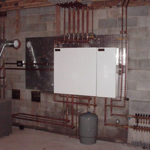

    Thought you might like to see a picture of a radiant heat manifold from a recent home. I couldn't get back far enough to fit it all in. When you add in all the tubing in the floors you have a considerable amount of water to heat. Because the radiant heat does part of it's job by heating up the mass of the flooring, it is very hard to control. If it gets too hot, you have to open the windows, too cold and you just wait. The amount of energy it takes to heat all that water is significant. If you have a leak, well, lets not talk about that!
    Comparing radiant to forced air is hard. They are entirely different. I'm a carpenter not a heating expert but I've been around long enough to see a variety of radiant heat over the years. I doubt if there is one radiant electric system from the 70's that is still operating. With the cost of oil, the folks that own the one in the picture can't afford to use it. Good thing they have wood back up.
    I'm still skeptical of the radiant systems. Some folks swear by them but I think it depends on many factors. I know the quality and controllability of forced air. In another 25-30 years I'll have a better take on the radiant.

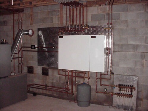

    2. Piccioni | Aug 12, 2005 10:01pm | #21
      That is the coolest picture!
      I designed and installed a radiant system for my house - it works perfectly (well for the last 5 years, anyhow) - and it is not even a third as complex as the system in that picture. And I'm heating 8,000 sq feet of main floor and basement, plus I have DHW off the radiant boiler.
      If simple works, use simple. A basic radiant system needs a main loop, one or more temperature regulated loops, distribution manifolds, distribution loops, some circ pumps, optionally zone valves, and a control unit. The boiler helps too. My entire distribution system fits on a 3x4 piece of plywood with room to spare. I never even bothered to hook up the zone valves because the heating is nice and even.
      Now, it may be that I have no idea what I'm doing, but I'm awfully suspicious of the guy who put together that monstosity, as good as a plumber he might have been.
      Of course, if the customer is willing to pay for all that wonderful plumbing, why not!

          RBean | Aug 12, 2005 11:24pm | #23
          If you go here...
          http://www.healthyheating.com/Seminar_Downloads.htmthen scroll down until you find the slide show called:
          Prefabricated Hydronic Control and Boiler Systems (7.9 mb)
          (on a high speed wireless it shouldn't take more than 22 seconds)It's a presentation on the evoltion of residential boiler rooms concluding with the developemnt of prefabricated systems.This attached picture gives you (in my not so humble opinion) an idea of where boiler rooms are (should be) headed.RBean

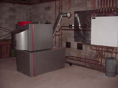

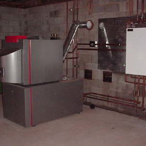

            RBean | Aug 12, 2005 11:41pm | #24
            Here is the other half of the same boiler room.<!----><!---->
            These panels are selected from a catalogue like any other hydronic product.<!---->
            They're prewired, tested and certified to UL/CSA standards...the better ones come with a plug...mount, connected, fill, test and plug it in.<!---->
            Many people think these products "dumb" down the industry but in fact, it takes more engineering skill to use them since the piping distributing and heat terminal units have to be designed around a standardized product with fixed capacity rather than design and build custom panels for each job. <!---->
            To design around a catalogued item like a control panel requires a deep understanding of system hydraulics and control applications such as valve authority. <!---->
            Lots of benefits, too many to go into here but if you appreciate installation efficiency based on standardization, reduction in job site wastes including labor and materials and cradle to cradle philosophy then it should be too difficult to grasp the beauty of these factory built systems.<!---->

      2. ~~Hammer1 | Aug 13, 2005 04:38am | #30
        Monstrosity is the word, Piccioni. I've seen others that are as big. This is the realm of the heating installer, I've got all I can do handling my end. That house not only had radiant in the floors but also in the walls and ceilings. You could be talking four or five times as much as a floor only system. The owner GC'd this one so this wasn't anything I specified. The place is a timberframe with a large volume, in a cold climate. It's only about 4000 sq.ft. not counting the basement. There are four sheets of plywood on that wall. The ceilings in the great room are around 25' tall and the bedrooms are at least 18'. This is, however a rather modest house compared to some of the ones that look like resort hotels.Many of the heating systems that are installed in my area are done by plumbers. There is a wide range of experience and approaches. Although hydronic heat has been around a long time, it is still a bit new in my area for some. I like to keep things basic when I can. Obviously that installer had to be good with all those fittings and gizmos. If the sheetrock hangers hadn't punctured the Pex in several places...I think one of the issues with radiant heat is that you can't turn it on and off when temperatures fluctuate. As another poster mentioned, a lot can be done to conserve energy with insulation, orientation and a bit of common sense. It's a shame this country doesn't have a better handle on consumption and relies so heavily on fossil fuel. We should be light years ahead of where we are. People in other parts of the world think Americans are gluttons, I wonder why.
