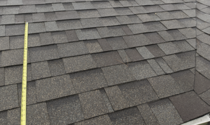

For a kitchen remodel, I am adding a range hood with the exhaust vent through the roof. The roof pitch is 4/12. Gas’s range is on the first floor of a ranch house on an exterior wall with a standard soffit. My question relates to placement of the roof vent. If I go straight up with vent it will be 39 5/8″ from first shingle to center of the 8″ vent pipe and 60″ from center of valley to center of the 8″ vent pipe.  I  live in central Iowa so snow/ice are an extra variable.
Is this an okay placement or should I move it further from up the roof and/or further away from the roof valley. If so, what should be the minimum distances I should use? I couldn’t find or don’t know the related building code for this.
See attached picture for general idea. Let me know if any other details would be helpful.

    I would go straight up. the worst that can happen during a heavy snow is that the vent will not work.
    this is not like a furnace vent or water heater vent that can kill you.
    even a gas stove is set up to operate in an occupied space.
    make sure there is a flap to close off when the fan is off. most hoods have these.
    Pay good attention to how the vent installs related to the shingles.
