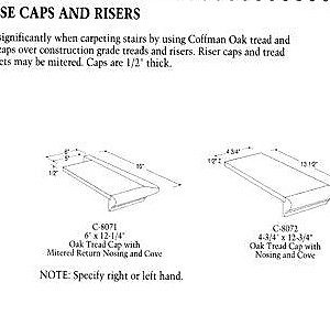

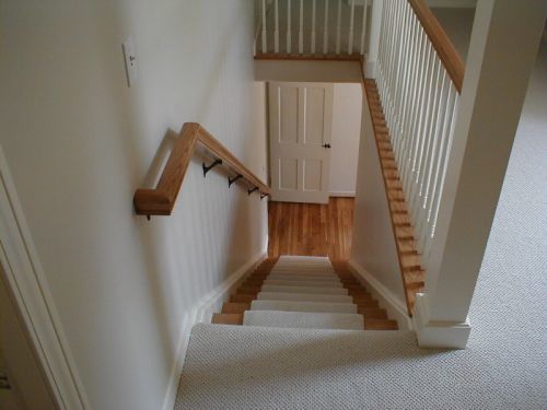

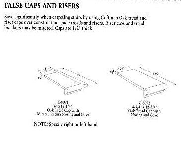

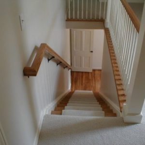

        Qtrmeg | May 28, 2003 11:27pm | #13
        From what you have said your stairs sound like shop built, not site built, and can't be taken apart.
        What you could do is put false caps on either side and carpet up the middle, (see pics). That would probably make too much sense, and be something you could actually do and have look nice though.
        Either way, why don't you use 1/4" oak plywood for the risers, or raisers, or whatever they are called.
