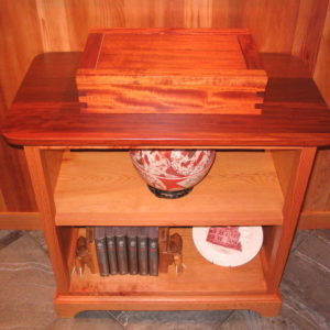

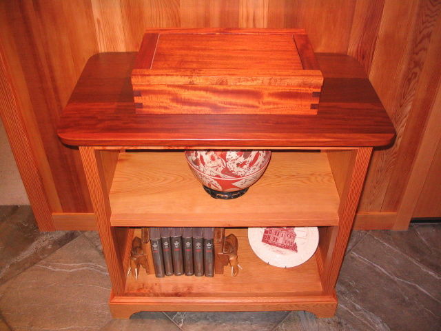

  9. hipaul | Mar 13, 2009 06:08pm | #27
    I reuse a lot of old doug fir framing pulled out of turn of the century houses here in the PNW.
    As everyone has said, it is a PITA. Much harder, more splits, nails, etc. But that being said, it doesn't stop me from doing it. And, just like the discussion about crowning, once you get into the routines of it, it becomes as easy as anything else that you do. It will take more time, but I imagine you're looking at the possibility of doing this from a sustainability point as opposed to purely financial?
    The best situation would be if your framer had a low-cost helper who could just cull through the material after it's deconstructed, pull nails, cut an end off each piece, look for anything really nasty, basically have it prepped and piled so that the framer can just measure, cut , and install.
    If they really are pretty much all 5 1/4" you can fur the wall out with 1/4" material pretty quickly to match new studs as needed.
    If you all decide not to take on the extra time and money to reuse the wood, make sure you get it off to someone who will. As suggested before, donate it HfH, or put an ad out to donate or sell it.
    The stuff I don't use for framing I keep in my shop and use for door and cabinet parts. Old vg fir studs and rafters become beautiful full size door stiles and rails, with much less chance of any warping once installed. Or mill it into trim (gotta metal wand that bigtime before milling though)
    There's a lot of furniture around here built out of it as well. This is a bookcase I made out of old rafter and stud material (plus 50 year fir shelves). The top is the stove cutout from some ipe countertops I made on another job.
    Don't know where you are, but wood like that is becoming harder and harder to find, and can live another hundred years with a renewed purpose.
