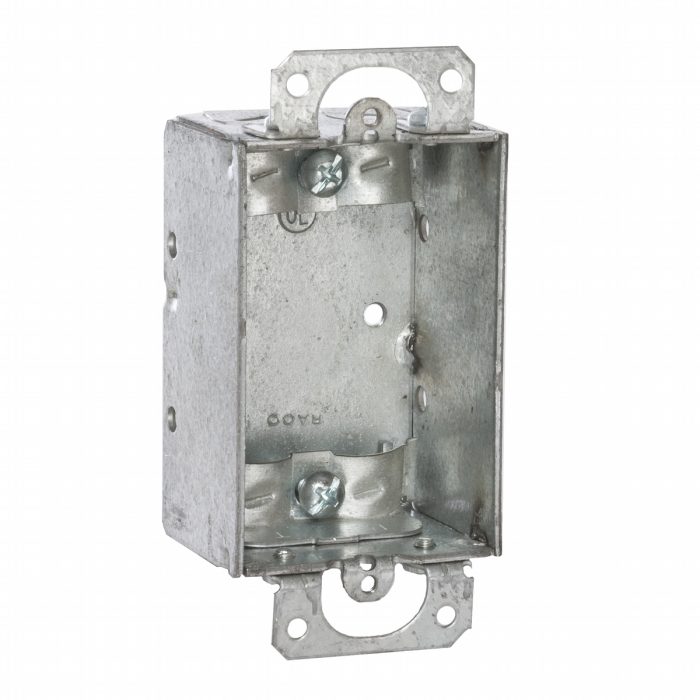

Check this very handy type of box.
410
By Raco
Categories: Switch Boxes
3 in. x 2 in. Switch Box, 1-1/2 in. Deep, NMSC Clamps, Plaster Ears
Specifications
410
Certifications
LEED Statement
NEMA OS1
UL COC - E195978-18
Many depths and gangable with extensions.

I don’t want you to remove them, just jut out a complementary “box” to allow you to install one of those old work boxes I showed. So it’s fastened to the basebd, holds the electric box, stained or painted to match, shoe mold to match and perhaps s complimentary trim on to and/or sides. The wiring would come up within that box out from below. Make it look as if the base jogged out and back.
