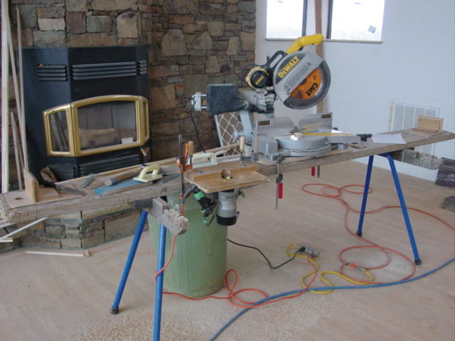

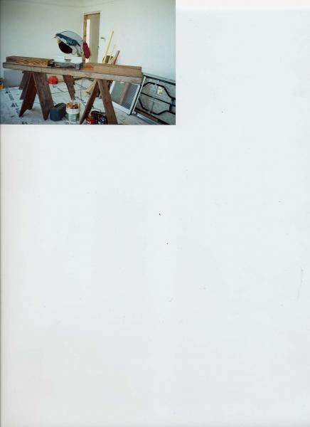

I worked with another carpenter last fall who bought one of those Trojan miter tables for his CMS. Had the table extensions and adjustable stop. Looked great at first glance, but I didn't like it anywhere near as well as my 20 year old plywood table. Only take maybe an hour to build and it's plenty portable. Has, maybe, 1/2 sheet of 3/4" plywood. I'll try posting a photo.

That's right! Geez, I forgot all about that, kit. Only used it for a day, albeit a long one. Let's see...what were my impressions...very stable, I remember being surprised how stable it was with that Hitachi SCMS (now THERE'S a sweet saw) on it. Nothing else I remember except maybe how compact it must be when folded up...I agree, I like the constant support of the extended saw table better than intermintant supports.
Hey, here's something. When I first built my table it had a fence running the entire length. I soon learned that was a nuisance if the material wasn't straight and removed it. Haven't ever missed it.

Novy 7 - thanks. Real compact in the truck and plenty solid. I think I must have gotten that idea from "Tips & Techniques" or something. Built those years before getting ideas here on Al Gore's internet.
