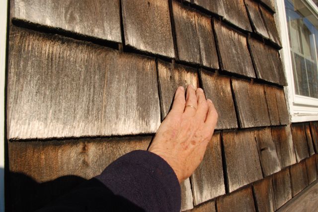

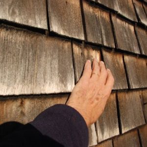

            i  built  two  capes  right  up  the  street   from  my  office
              one  in  '77  and  one  in  '78....  both  with  cedar  clap  fronts  and  WC  on the  other  3  sides
            the  one  from  '77  was  resided  two  years  ago
            the  one  from  '78  is  owned  by  a  guy  with  not  much  money..  so  his  should  have  been  resided  10  years  ago  ... but  it  still  hasn't  been
            these  shingles have  many  holes in them  and  the  portion  just  below  each   but  is anywhere  from  1/16 to  1/8 "  thick  ....  all  from  erosion
            here's  the one  from  '78
            Edited 3/27/2009 4:37 pm ET by MikeSmith
